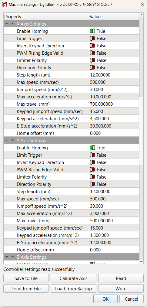

  • Go to Edit → Machine Settings
  • Scroll down a bit to the Vendor Settings section
  • Click on small triangle to open that section
  • Agree you want to continue
The X and Y Axis sections should look like this, perhaps with slightly different wording:
Verify that Enable Homing is True for both axes.
If the other values resemble what you see above, then
  • Unplug the USB / Ethernet cable
  • Turn the machine off and on again
  • It should attempt to home
If the head starts moving away from the home switch on either axis, invert the Direction Polarity switch for that axis.
If the head moves very slowly on either axis, invert the Limiter Polarity switch for that axis.
If the laser head sits there without moving at all when it’s turned on or reset, then the controller is defective.
