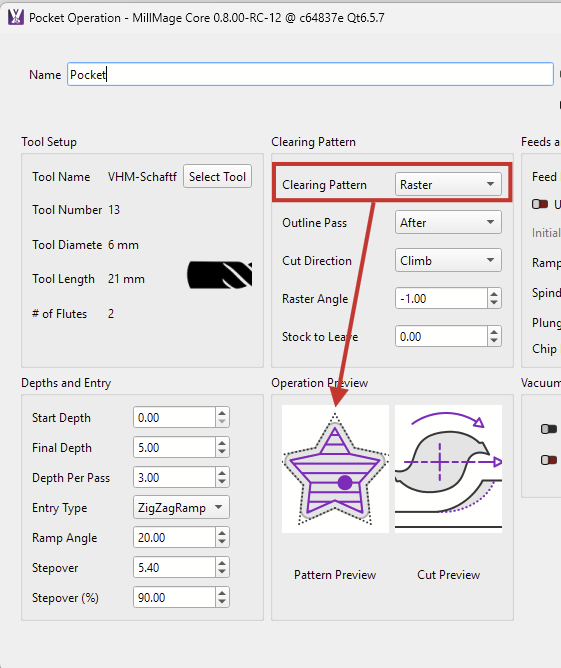

You can already do this with the Raster Clearing Pattern:
If you use Offset, it’s still limited to 50% until we have Medial Axis ready. This is a complex geometry/math problem that needs to be solved for every shape. We are well on our way to doing so and are still testing a few edge cases.
