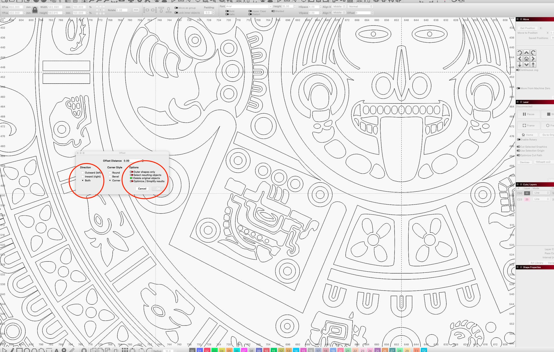

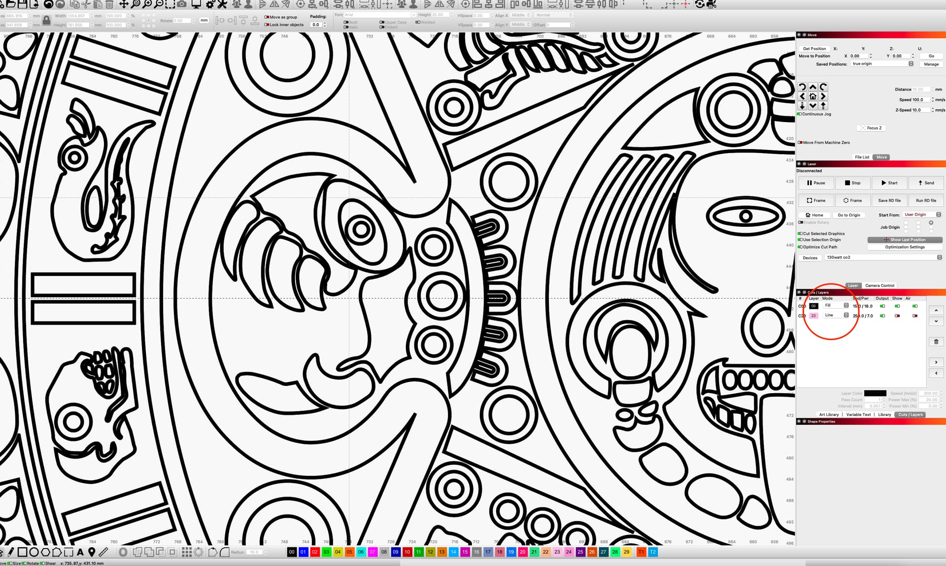

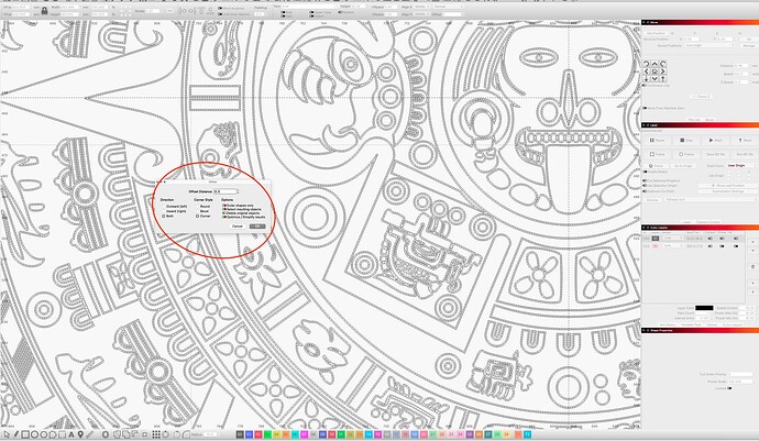

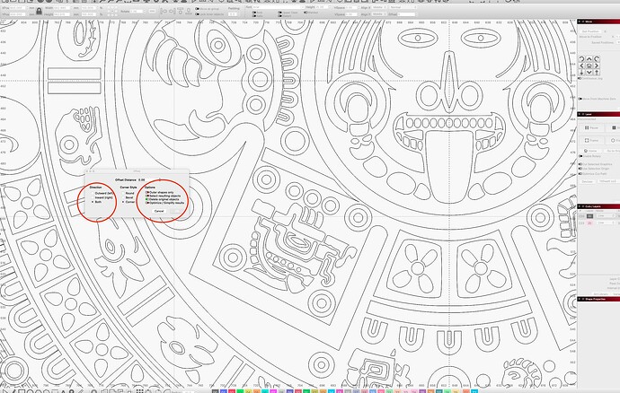

There is a workaround that works for me. If I want to increase the line thickness when engraving a vector file I will use the offset tool. If you set the offset to “both” & set your offset to half your preferred line thickness. You will need the activate the switch to delete the original line.
