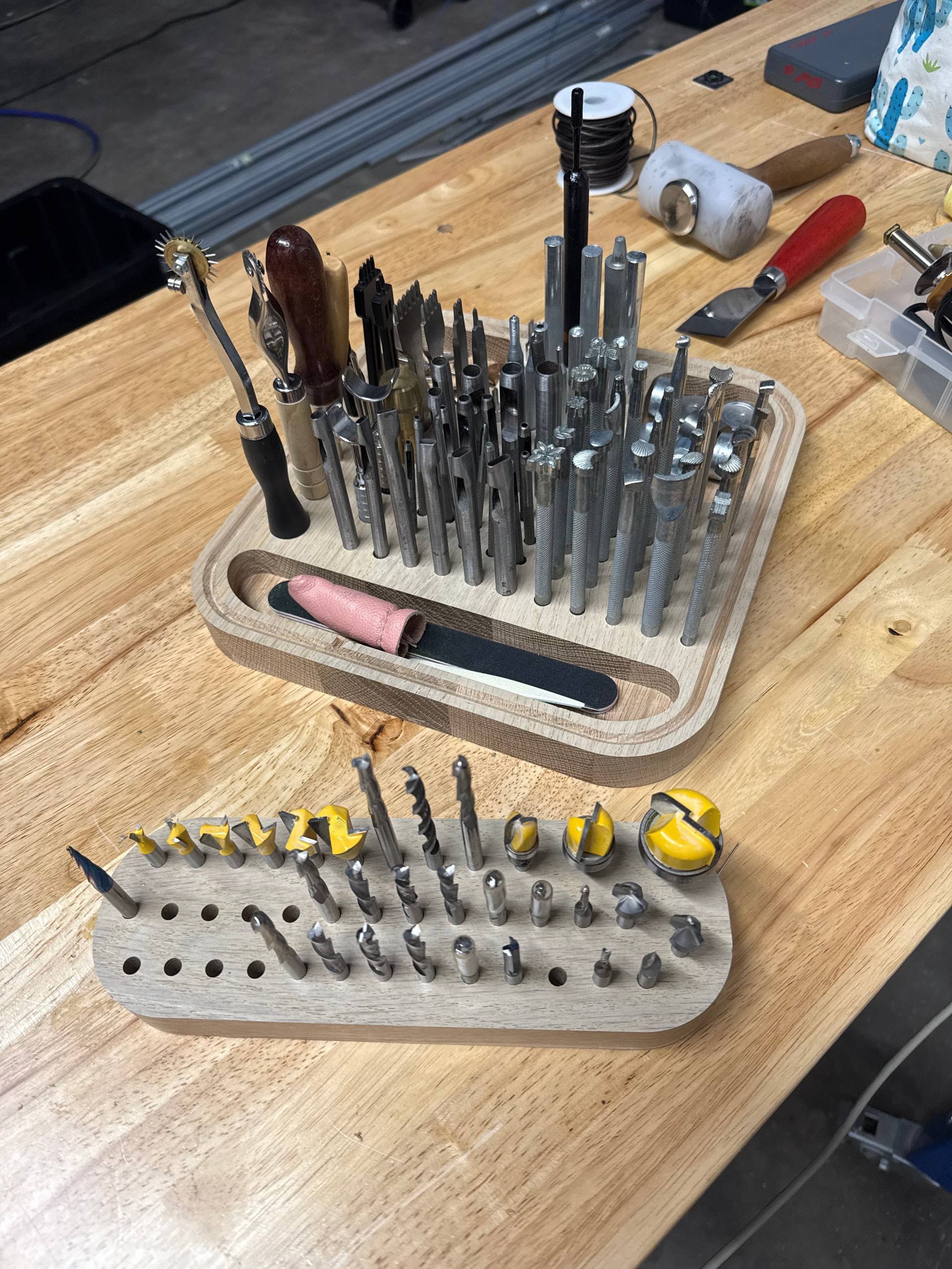

I have 4 metal cases of drill bits holding numbered, lettered, decimal and imperial bits.

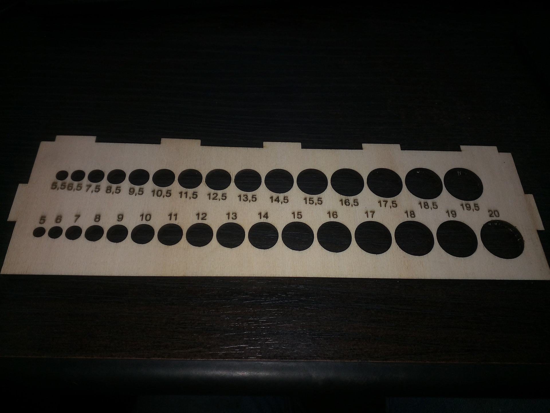

I measured some of the holes and on average the hole size measured between 0.17mm to 0.2mm larger than the bit
I don’t know how big your kerf is on your laser, but with the 0.06mm dot size on my laser. I think your holes might be too small.
Why not create a 40mm square and cut a 20mm hole to see how the 20mm bit fits in?

I confirm that the Kerf will have to be around (upwards) the values ​​you mentioned (0.2).
I already did a first test on 4mm plywood and the drill bits go in if you force them a little. Therefore, 0.2 or slightly more should be enough for the drill bits to fit freely.

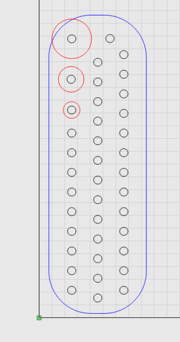

This was a fun read. I just made my own bit holders last week. I’d encourage a feature request for specifically incremented holes since Copy Along Path doesn’t quite cut it.
We welcome suggestions on new features at https://lightburn.fider.io/ - we’d suggest you make a post there detailing the feature you wish to see. We use Fider to help us choose which features are most important for us to develop next.
I did mine in MillMage, but the same design tools apply.
I hope you post yours when it’s done!

Here is the first cut that serves as a guide for the following adjustments.
A drill stand needs some slop because sometimes a drill shank will get a burr on it.
Positive Kerf = shrink the holes.
Negative kerf = open them up.
we file the burr off.
It’s finished!
Don’t tell anyone, but only after everything was assembled and glued did I realize that the holes in the second section were too tight and the drill bits don’t go all the way to the bottom. :innocent:
I don’t know where I went wrong, but convinced that everything was fine and eager to finish the job to show it off, when I went to put in some drill bits to demonstrate, I realized the mistake and will have to widen them, either with the drill bit itself or with a roll of sandpaper.

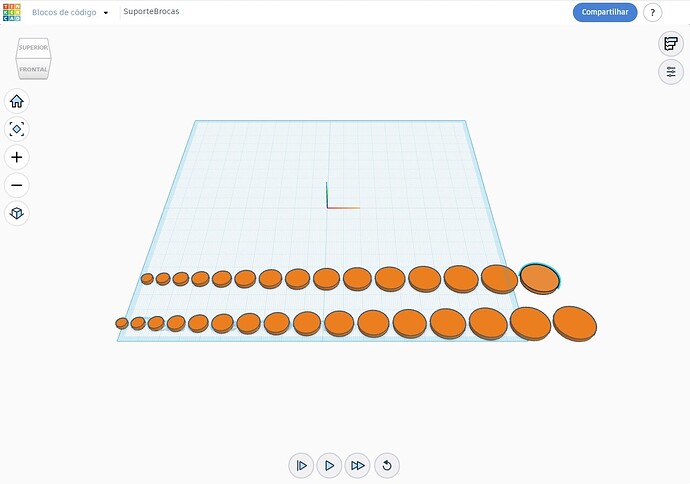

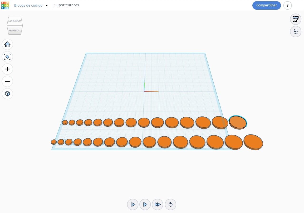

I hope I won’t be insulted for mentioning another software that I use occasionally when things get complicated.
I don’t consider it competition to LB, but probably to Millmage, since it’s an online 3D software. It’s Tinkercad.
I don’t master it (not even close), but my brother, in his own way, understands it. So I decided to give it a try, and although neither my brother nor I had ever worked with block-based programming before, after a few hours of trial and error we managed to draw the holes. The truth is that someone familiar with that software can draw the holes in a few minutes because the programming isn’t very complex. For ethical reasons only, I won’t post the programming, but I’ll show the drawing.
