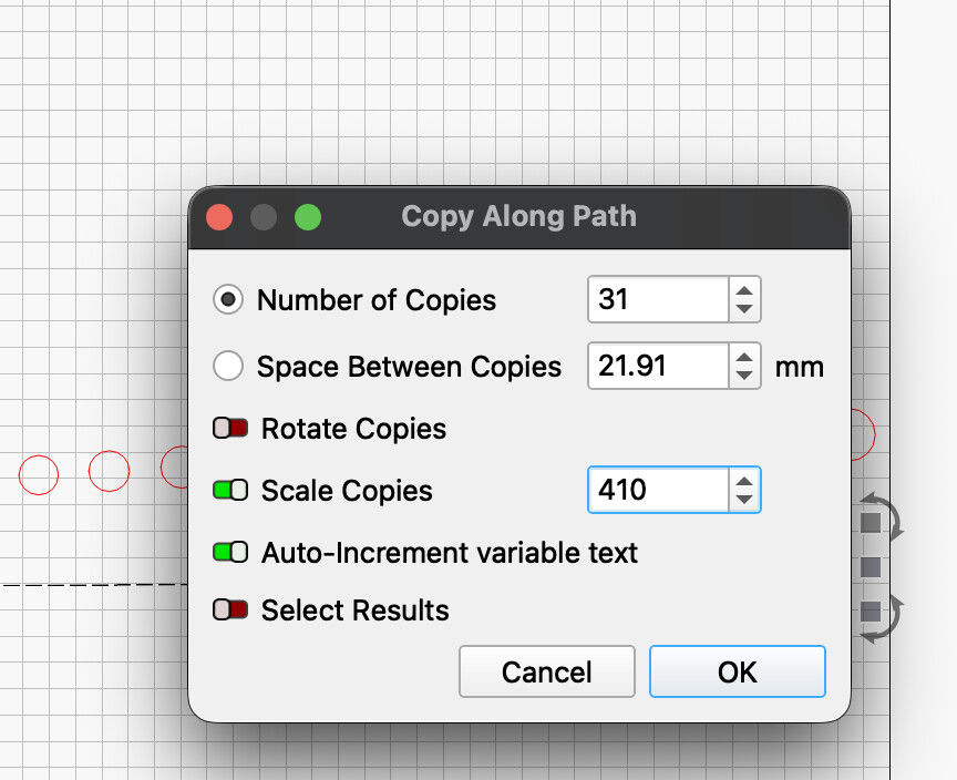

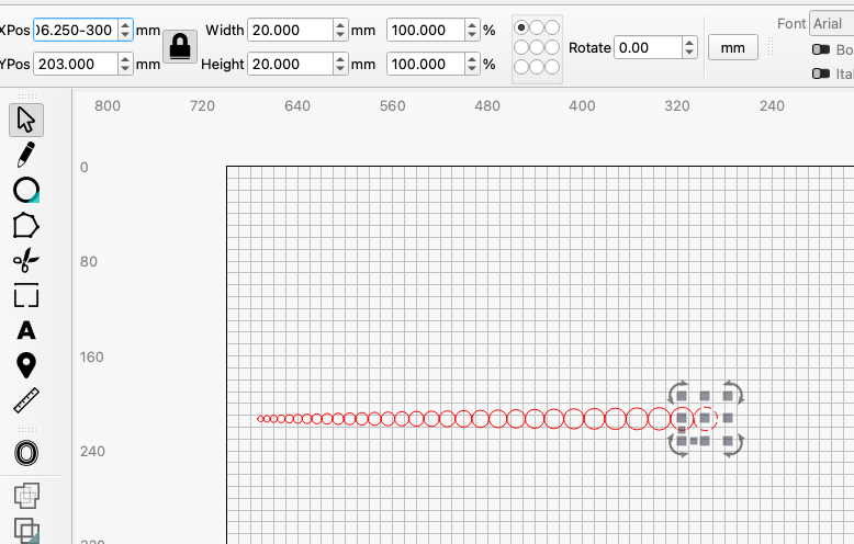

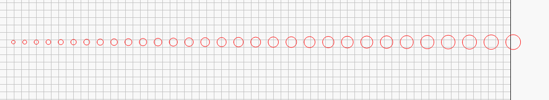

I took on the challenge of your project. The way I found to get the evenly incremented holes is by using the copy along path tool. It took experimenting to get the scaling just right, and I’m sure there is a mathematical formula for finding the correct scaling, I just don’t know it.
I drew a long line, then a 5mm circle, selected the circle then line(order is important) and went to Arrange Menu> Copy Along Path. In the dialogue I entered 31 copies, that’s how many are required to get from 5 to 20 with .5mm steps, 30 only gets you to 19,5mm. I selected scale and entered 410%. I arrived at that number by trial and error.

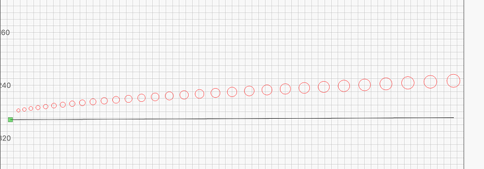

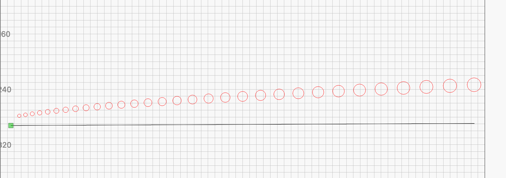

This was the result. 31 holes, evenly spaced with a .5mm increase in each one. The thing I cannot explain is the holes are not aligned and even if I select all and try to align to the line they don’t align with the line properly.

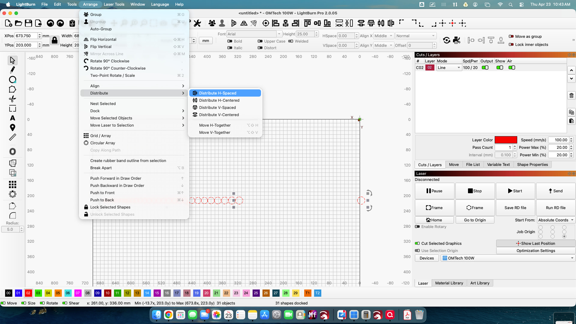

For one solution you could select the entire set of holes and move together.
Then select the last hole and move it by the desired spacing x number of spaces. In this case 10 x 30 = 300mm
Select all the holes and distribute h spaced.
You now have a row of holes spaced 10mm apart.
It turns out that my line wasn’t perfectly horizontal, that’s why the holes didn’t align properly.
After using your “incrementing object size” I bottom align all the circles. Then I distributed the circles but I found that one couldn’t adjust the spacing.

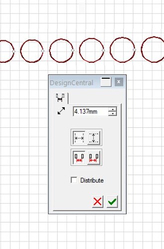

I some other software doesn’t do “incrementing object sizing” but I can adjust the spacing between the objects to any spacing I wish. So I exported from LB then imported to this other software.
Now if either one of these software could do it all it would be great!
(I accidently deleted my other post)
You need to move one of the end circles to the required position before distributing. That’s where the formula distance x spacing comes in. Reread my previous post.

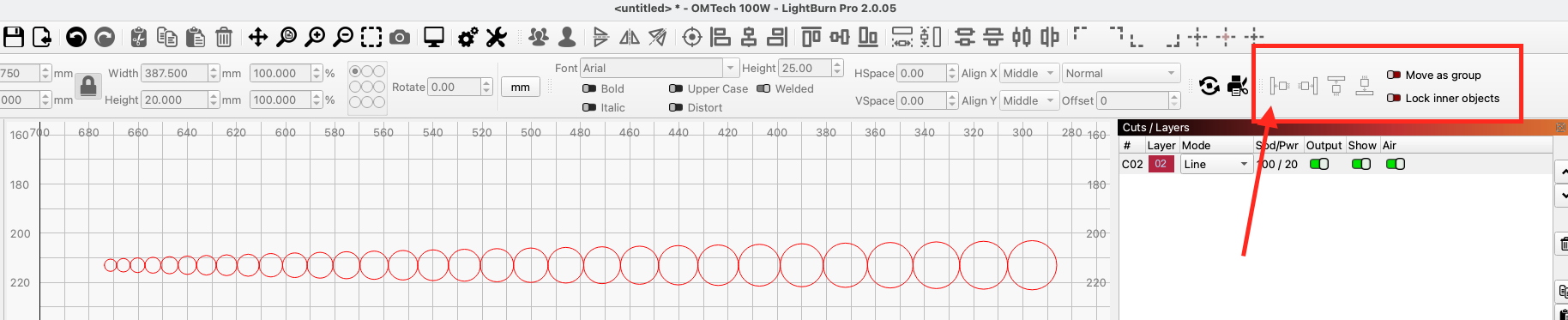

While I’m exploring @thelmuth solution, I’m encountering this “bug”.
What must be happening is that the properties of the original object are “saved” in the generated objects.
That’s why the dimensions in the top bar are correct, but the properties are wrong in relation to the selected object.

It is the change between the first object and the last object as a percentage. So 20 mm is 4 times large than 5 mm, which is 400%. But 400% larger than 5 mm doesn’t work out exactly 20 mm so I had to experiment and that’s why I came up with 410% that actually worked. I don’t understand the math. I just know what worked.
