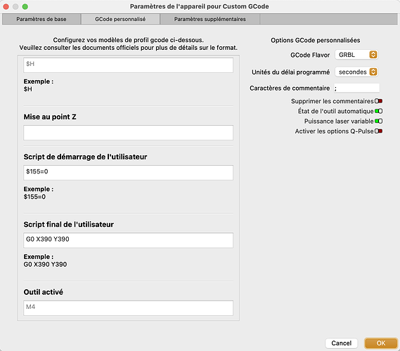

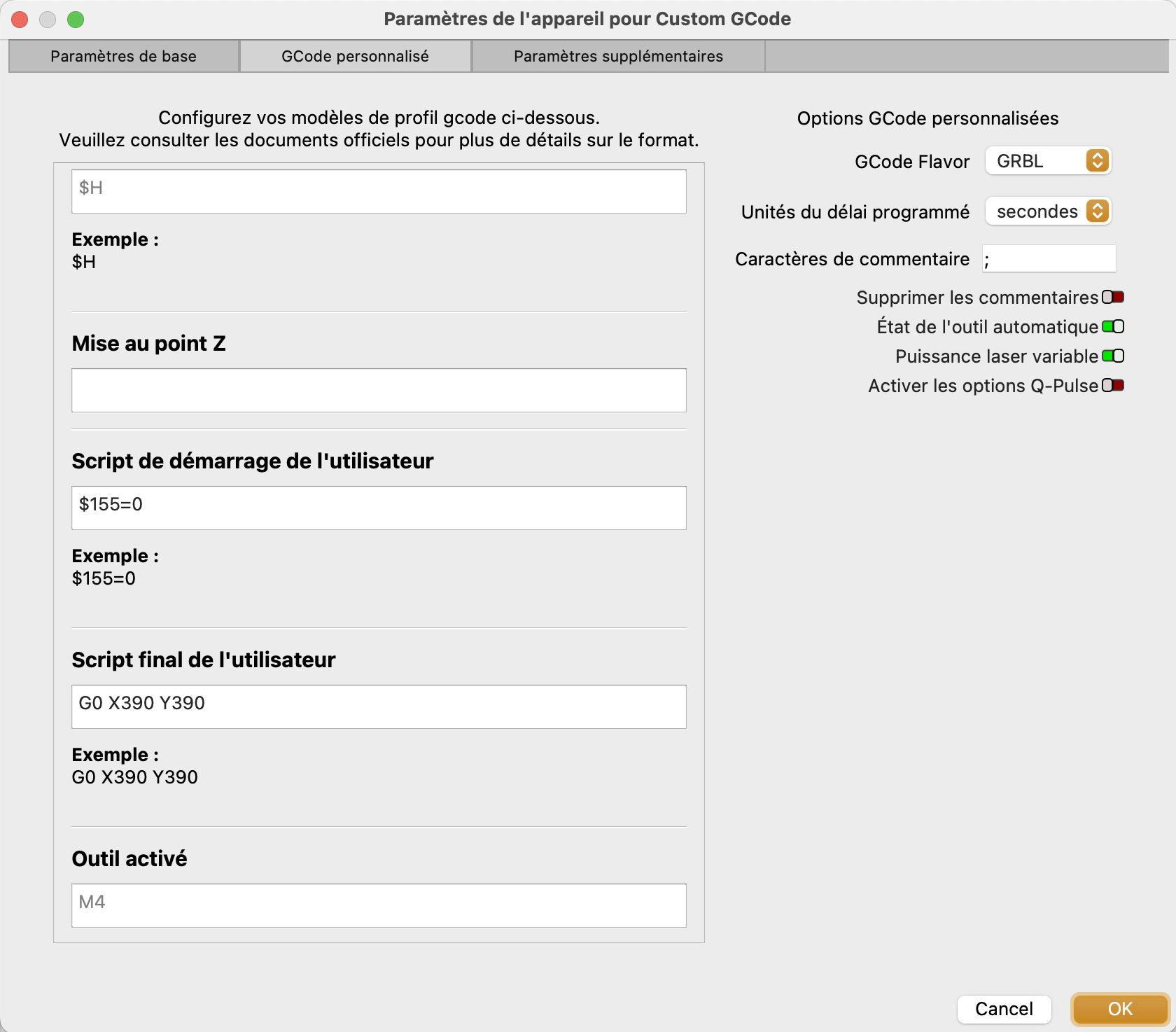

Hello,
I have a Falcon 2 pro and I want to add the code: $155=0 to remove the lens alarm. I work with lightburn on SD card. Is it possible or do I have to do it with a computer in USB-C? Here is what I tried but nothing happens, the alarm still gives…
Can you help me? Thanks in advance.

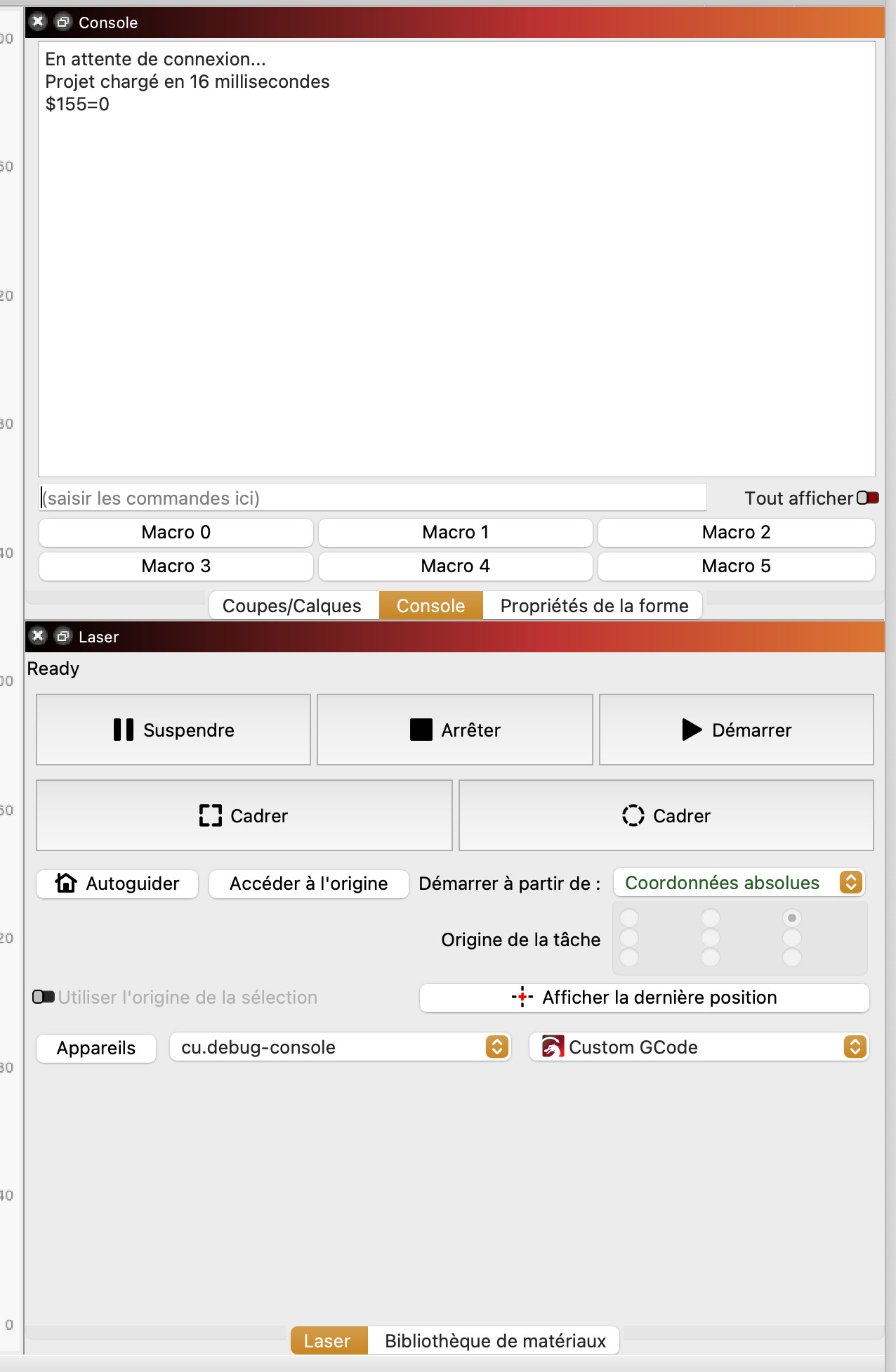

I already tried to enter the code $155=0 and enter. But when I save the project on SD card it seems not to take into account the code $155=0. That’s why my question?
So, when you run a job over USB, you don’t get the error?

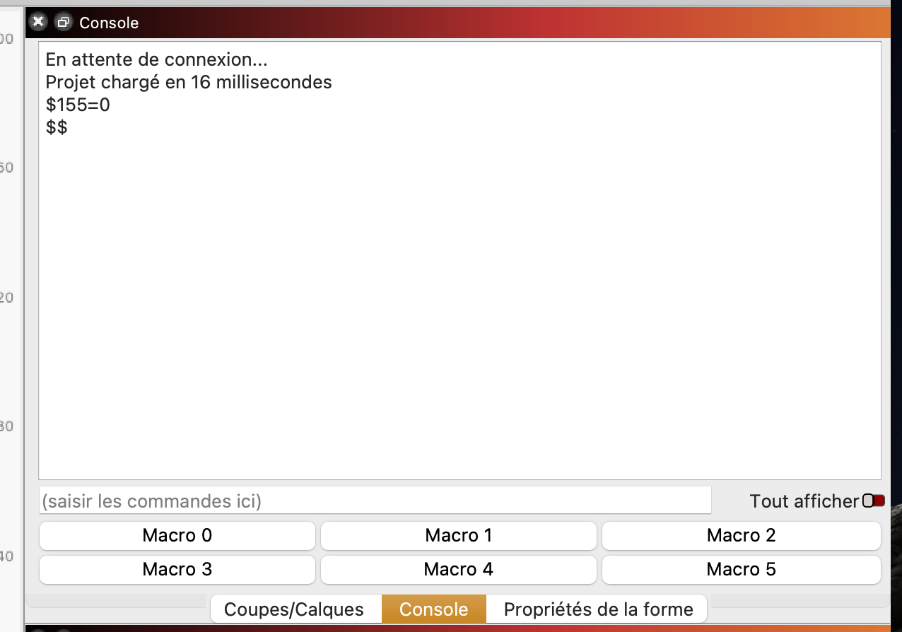

If you type $$ in the console, it shows you all the firmware values. Check to see if $155 is still 0 after a reboot.

$155=0 changes the Firmware values on your controller, so your laser needs to be connected to your computer while you enter the command.
