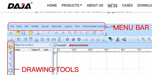

You are stuck with their software or make a control board change… Might ask them if you can do that… Don’t get your hopes up… but you never know.
If it operates via EZCad2 it might be compatible…
This is a video on drivers… it’s targeted at EZCad2/3 but if there is a chance of getting it to work with Lightburn, this will probably have to be done…
Despite several hours of trying to make it work with Lightburn, nothing actually works. I imagine that it is therefore incompatible and usable only with the software provided by the manufacturer
Indeed the manufacturer responds by email that it is not possible to use Lightburn and he sells identical machines compatible with this same software on Amazon. Definitely the Chinese logic is special…
They are NOT identical machines… they look similar…
It’s what’s inside, specifically the controller, not what it looks like… or does.
Cloud Ray sells machines that look identical, even the same manufacturer of the controller… some versions will allow Lightburn control, others will not.
