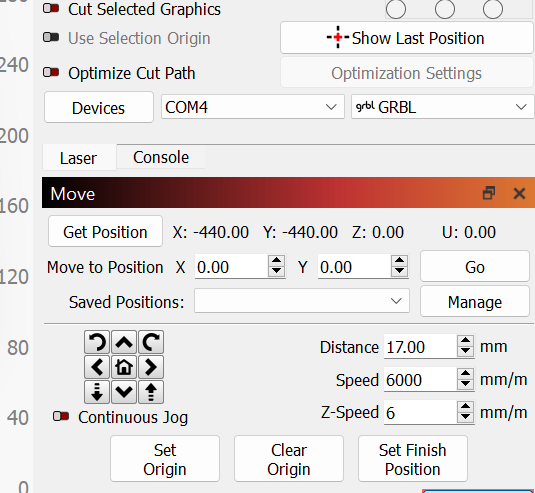

Installed trial version with Atomstach
Installed trial version with Atomstack 50W diode. I get negative values. How do I change?
G10 L2 P1 X-440 y-440 in the console window. You only do this once.
