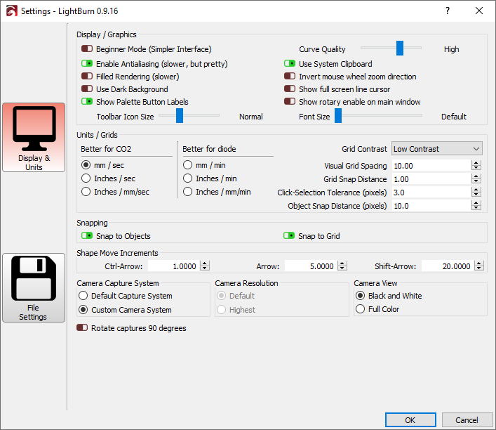

I just tried to cut a circle in 3 mm plywood and the 250/100 speed/power looked like it was trying to run the speed at 2500 because the laser drew the circle in seconds rather than minutes. Glad I checked this out as I won’t be updating my work laptop to Windows 11 until I know there is a robust version of Lightburn that can run on Windows 11.
You said “speed 250” - I’m guessing that your new install of LightBurn is in mm/sec, not mm/minute. Speed has units, and if you aren’t paying attention to those, you should be. :slight_smile:

The units of the original install is in mm/min and I don’t recall choosing it or even having a choice since it recognized my Emblazer cutter.
The new installation does show mm/sec, which would explain the issue, but it still shows the Emblazer as the cutter and no obvious place to change the units.
Maybe it was something that I had to choose when first installing it over a year ago but did not see any setup choices when installing the latest version on Windows 11.
Edit > Settings, in the middle where it says “Units / Grids”:

Question please: so you change it to the mm/min even though it doesn’t say for CO2?
This only affects the display, not the function. Speeds for CO2 lasers typically are higher than diode lasers so mm/s makes sense there. mm/min generally makes more sense for diode lasers. But ultimately this is about preference for how you want the information presented.
