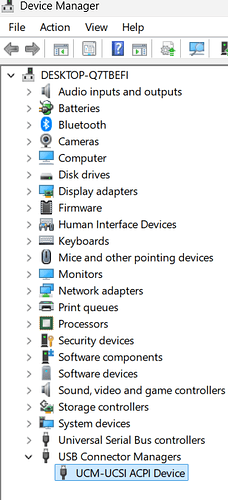

My lightburn/help doesn’t specifically say I have the Pro version but it does say “Device types enabled: GCode, DSP, Galvo”…
I have seen this video you suggested. I don’t have the exact files in Device Manager as it does in the video. I’m so scared to try this in fear of screwing up existing version of lightburn to my 2 CO2 machines.
Do I remove the highlighted device?

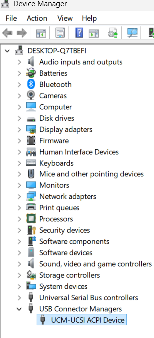

This is what my Device Manager looks like. I am not connected with a USB cable to any machine. Does this look normal? Do I remove the highlighted UCM device?
Beats me… I don’t use windows, so I can’t really advise you. I do know that Lightburn won’t work with the drivers for EZCad2.
I know the video fixed a lot of problems connecting. Using the wrong or incompatible driver isn’t going to fix the issue.
From my limited windows experience, it looks like there is a device connected or it wouldn’t show up.
Doubt you’ll break Lightburn, but you have to change out the driver.

I have the Pro version. I found a Lightburn help file on installing the galvo driver manually if I didn’t check the box to install it from the get go. Which is what I did. Did not check the box to install galvo driver on initial install of lightburn
Going to try that later today. Hopefully that fixes the issue. Nothing shows up at this point when I run “find my laser”…
Our docs are worth review and can assist in understanding. :slight_smile:
Thank you.. I will give it a shot.
Got it working! :partying_face: Installed the driver manually, ran Find My Laser and all is good..
