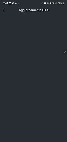

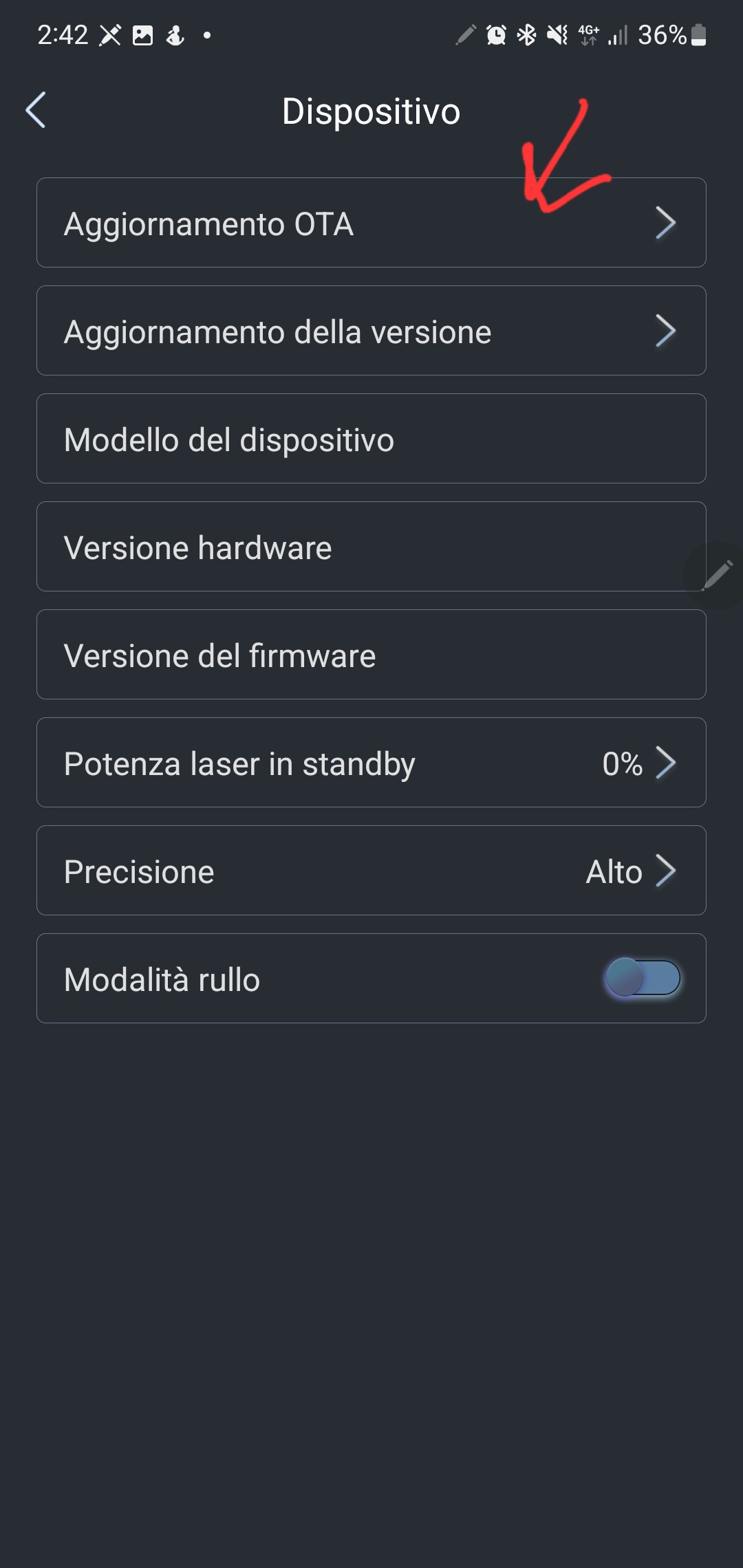

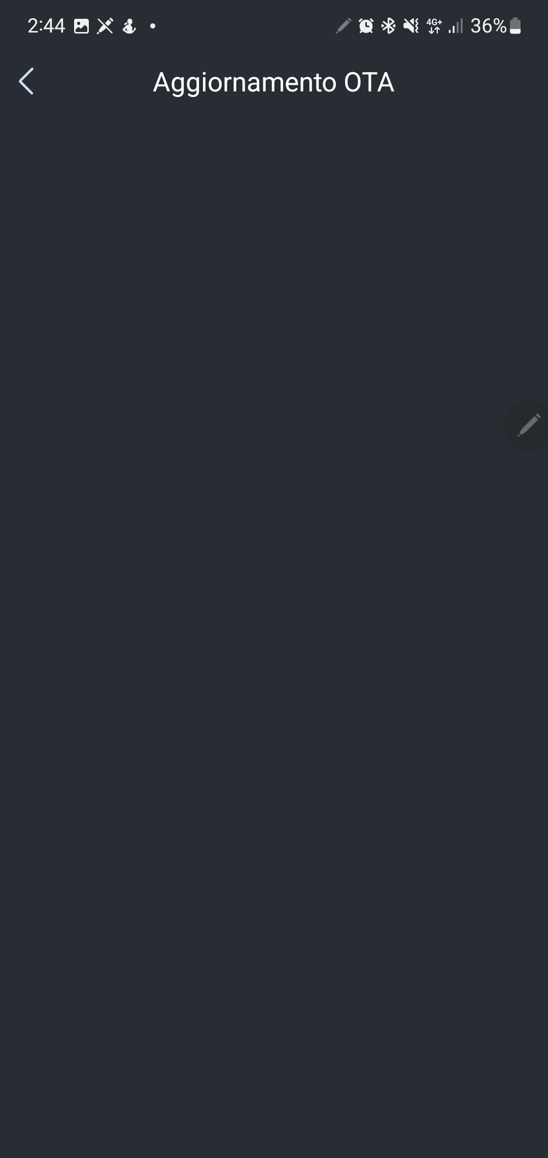

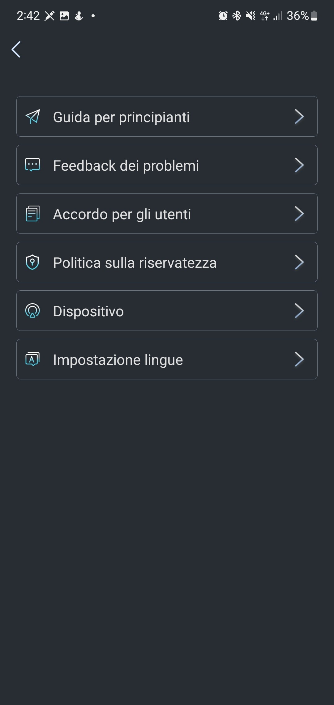

The phone app barely work, in Options,Device there is no way to flash the GRBL firmware. I’ll put some screenshots, unfortunatelly if i try to put english lenguage the app will become in chinese.
