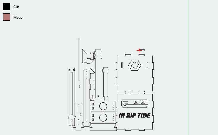

When I cut this entire Job for some reason the purple-highlighted parts were shifted about 2mm up. If I recut just that part, it cuts as designed.
You can see if I overlay the two parts that match this puzzle the narrow slots line up as designed. One thing I knotice is the hex and slots are cut early before the outer profile is completed.
I attached the Project. Are there any settings I should look at? This is not the first time I have had a set of key holes or tabs not cut as designed
RipTide V3_1.lbrn2 (76.4 KB)

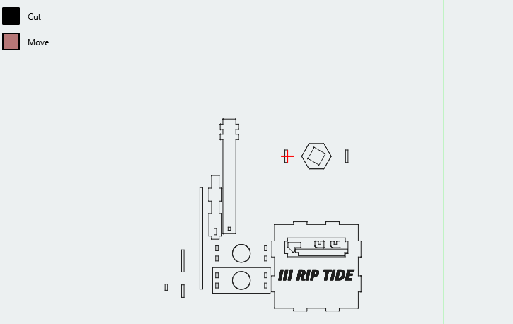

For those who may have insight here is the moment the inner is cut
It finnished a few of the other shappes then returned
This is a bit concerning if a person was to run an even longer job.

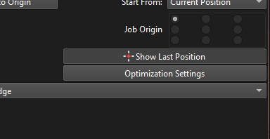

To adjust how LightBurn cuts your shapes you would make adjustments to the Optimization Settings, here, in the laser window:
We have full documentation for how each setting works here:
