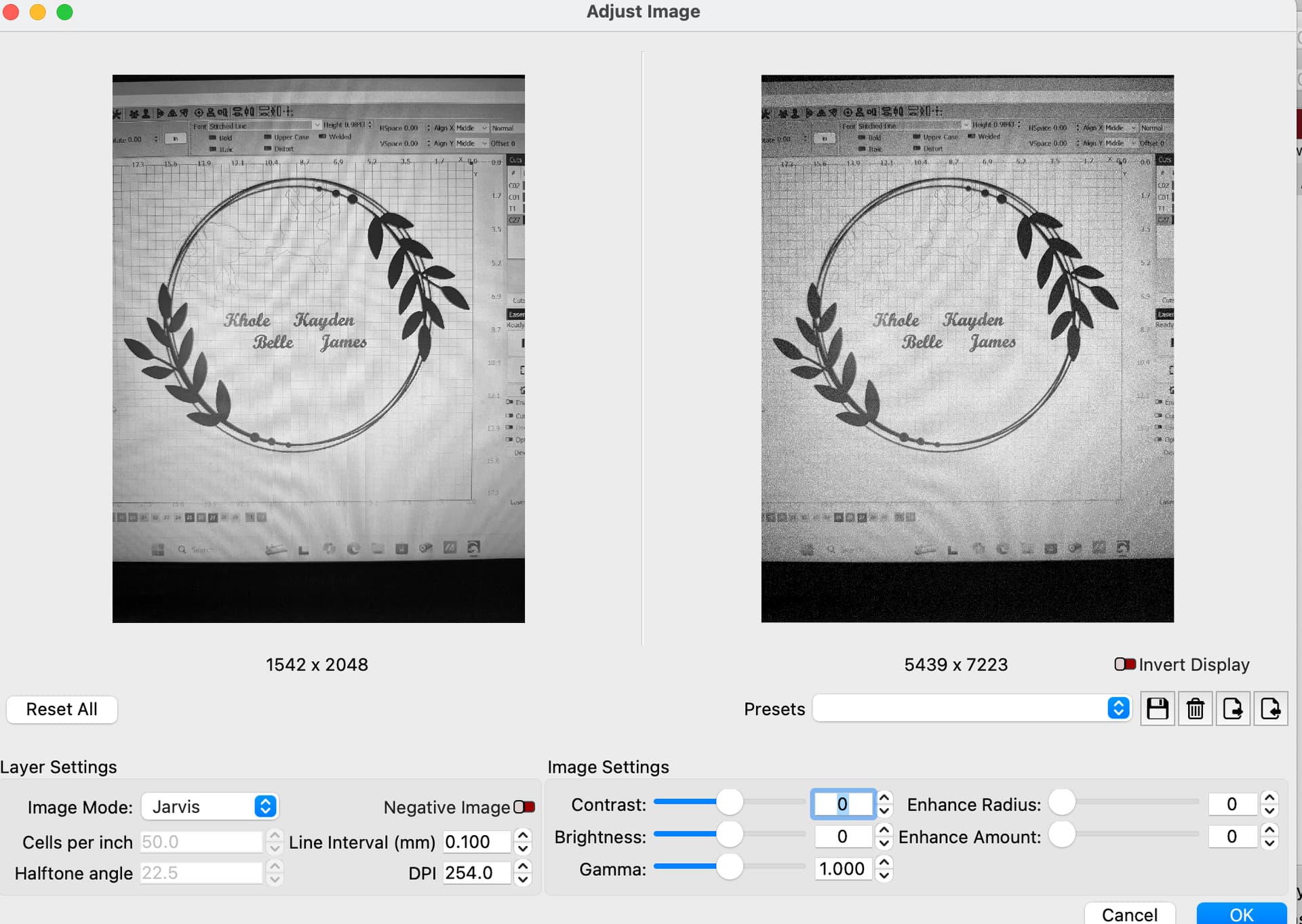

Lightburn seems to double my image size when importing (at least) jpeg images. I’ve basically tiled and set dimensions for a multi image jpeg, set the size to 8.5 inches by 8.8 inches (215.9mm x 223.52mm). The exif data seems right; every other image editor/viewer etc sees the file at the right resolution (2549 x 2639 pixels) but importing that image into Lightburn doubles the resolution size. I can just resize the image to fit.. but why the extra step? there’s 20 images in total, which means I have to resize all images on import.

It has something to do with the DPI the image is created with and the default Lightburn DPI. What you can do is right click on the image and select Adjust Image, then change the DPI until your output image matches the original image.
Before
After
Then, if you will be doing this a lot change the default Lightburn setting for DPI in the Cut Settings Editor. (Double click on the Cut layer)

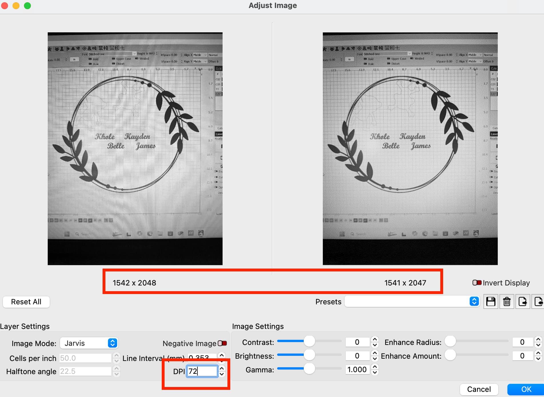

What I discovered in my testing of the issue is, it uses the default settings for the layer the image is imported to. In my case it was the Lightburn default for the 00 layer of 100mm/s, 20%, 254DPI and Jarvis image mode. When I opened adjust image you can see the jpg is consideribly larger than the original image. I had to adjust DPI to 72 to get it back to original size. I then saved 72 DPI as the default in the Cut Settings Editor, restarted Lightburn and imported the image again. It retained the 72DPI and size of the image.

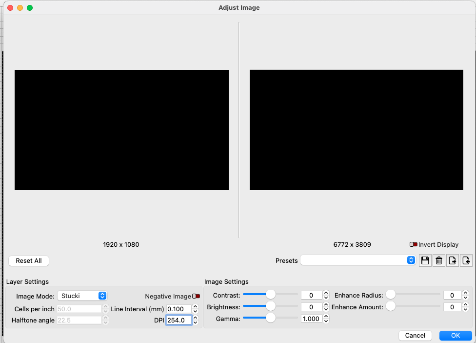

I imported a black rectangle. It is 1920 x 1080 pixels @ 72DPI. I did the math and that should equal 677mm x 381mm, which it does, or close enough. However, when you go to the adjust image dialog the imported size is 6772 x 3809 @ 254DPI. Resampling the image at 72DPI changes the pixel count, but doesn’t change the actual size of the image.What I just realized is that Lightburn is resampling the image at the correct size as created and adding extra pixels to get the resolution to the value for that layer.
