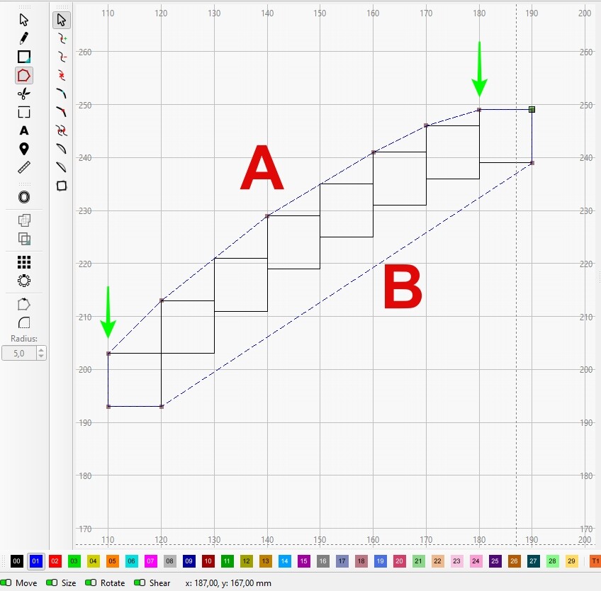

My goal with this topic is to learn a simple way to connect multiple points.
To illustrate what I’m trying to achieve, I drew this to try to explain.
After drawing the squares (imagine as an object), I created a rubber band that resulted in the line shown in blue.
Editing the nodes, I did the following:
I broke the line at the green arrows to create line “A” and line “B.”
If I delete line “B” and place line “A” at the points where line “B” touches, I get what I want to know. (can you imagine line “A” touching all the points of the object?)
This is possible because the top and bottom faces of the object I created are symmetrical.
If the faces aren’t symmetrical, how can I get the final line “A”?
Any ideas? I’m open to suggestions! :laughing:
I think the easiest way would be to make a line connecting the endpoints and add nodes. The nodes can then be easily and smoothly dragged to the desired points.

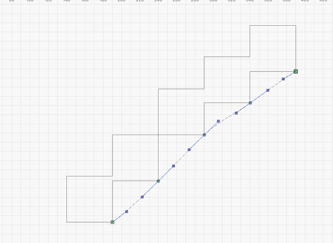

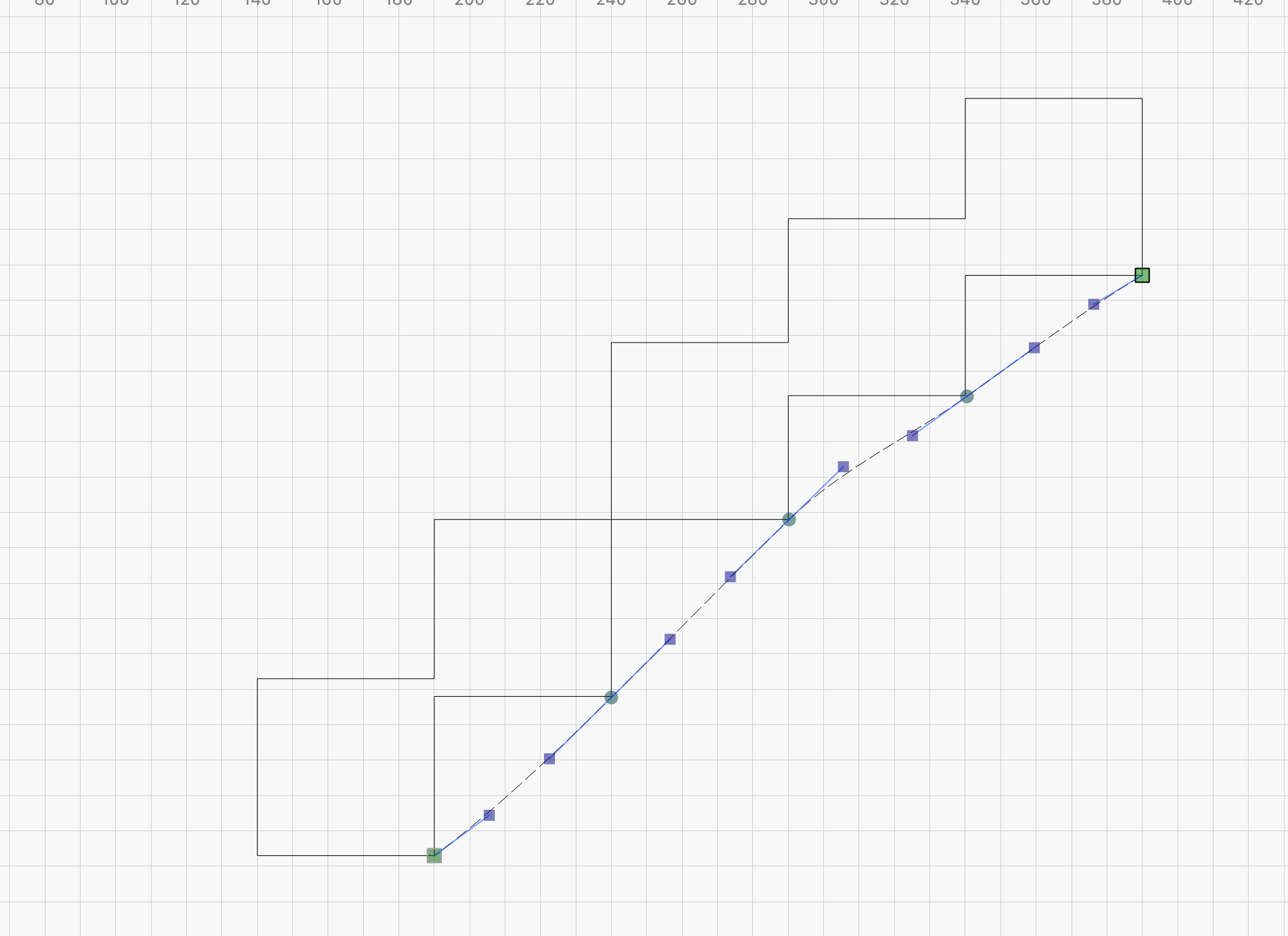

Is it suitable to use the Pencil and place a point at each corner along the path.
Peter, where did you see a Point command in Lightburn?
The Pencil tool in the toolbar..under sele tion arrow.
I just now, drew a rough polygon type shape but did not close the shape, and then switched to selection arrow…which brought up the green square, I dragged it to the grey square (finishing point of shape) and gave it its own layer.
