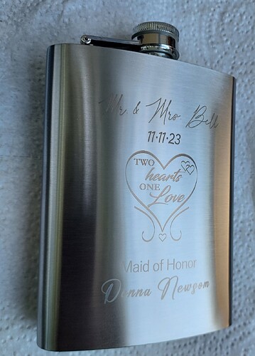

Ok… So here is what makes my head a hurt a bit. My thought process is to basically “mark” the flask. Similar to what I showed in another thread on a stainless steel tumbler. Pure black. Now I really don’t care if I get black, or just a nice etched / engraved look. This flask has both.
On the edges it’s black’sh. Down the middle it’s “etched” per se’. This was a 200 mm lens. How do you get just one look from an object that is slightly bowed? Can you?
My settings were 600 speed, 30 pwr, 30 freq. 2 layers. One +45 angle, the other -45. These are my “marking” settings on Stainless steel. I can’t figure out how one goes about marking out on the edges and in the middle and get a uniform look. These are 8oz Flask.
I left the flask where it’s at in case I can save it. If not, it’s all good. I don’t want to ruin 5 more if possible to get 1. I think my settings are close, but no cigar.
Talk to me…
It’s caused by a change in focus… You might have to focus for the middle area, so to speak…
A lot of black marking is done slightly out of focus.
Did you use cylinder correction?
Hello there ma man. Na, never thought about cylinder correction to be honest.
I’ll try to look into that.
The width of this flask is 93.2mm
I’m sure folks are engraving these things. I just need to figure out how.
Footnote: I’m closer now Jack. It’s all the same color. It looks “marked” -vs- etched or engraved, which I what I’m really after. Been a very long day here on the farm. Will do another one tomorrow and post the settings and results. Thanks for everything.
If H is the height of the entire engraving across the surface fo the mug… you want to focus closer to the middle…

Thanks Jack. I need to watch that cylinder correction video a couple of times, but I’m really close. I think I have a sellable product now. My settings are 1000, 60 pwr, 300 Freq, .0300 LPI, single pass, no x-hatch.
Going for a straight up etch look -vs- black marking.
