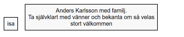

Is it poosible to get a dynamic frame thats centers around text?
Hello creative people.
Iam on a misson, i need to make atleast 2000 fairly simple signs.
Is there a way to make a dynamic square thats adapting to the csv imported text? Or is the most simple soulutions creating an html and converting it to an svg-file somehow?
Other solutions would be appreciated. There is no way possible to squueze the text for me,

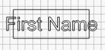

I don’t think it’s possible in Lightburn to have a line adjust. You can very easily squeeze the text though. Select the text variable, go to the shape properties box and input a value for max width and also select squeeze. In my example I have a 100mm outline, the first is without squeezing, the second is with max width set to 90.
Yea the thing is that i dont have the time for single handly adjusting 2000 signs and the amount of text varies alot in my csv so some signs will come out insanly looking.
Ill just program to work outside lightburn.
