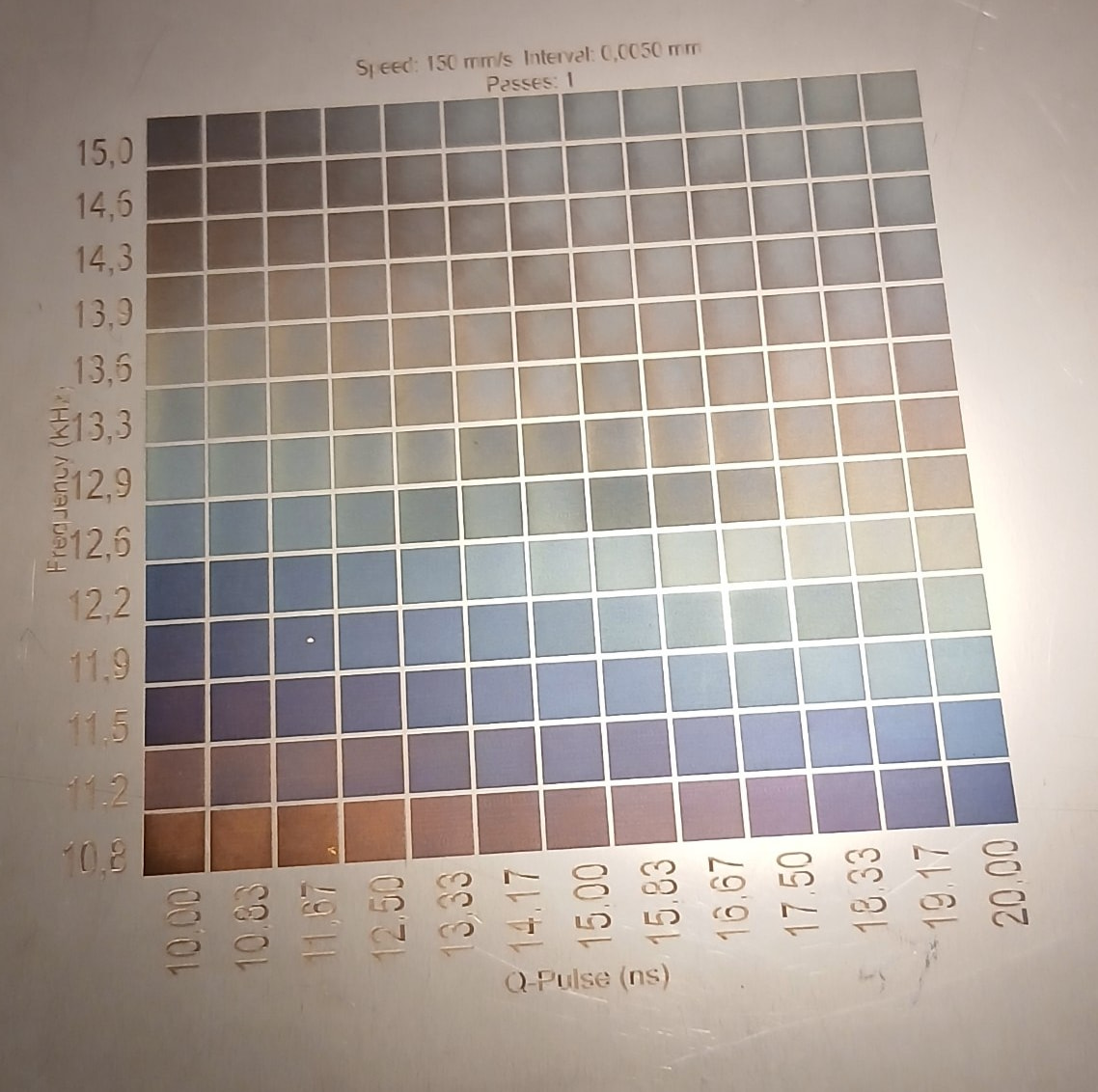

First of, a palette that i use. One of many these are my favs
you can get much brighter golds too but those shades are not my favorites. Red remains elusive as hell but i have gotten close by multiple passes

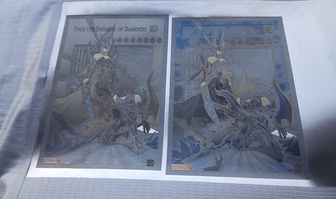

Here is my most recent commission work for somebody. Notice the red box bottom left hehe
The etch patterns follow the same principles as Guilloche, reflecting patterns at certain angles. Those are a post process after the whole card is done.

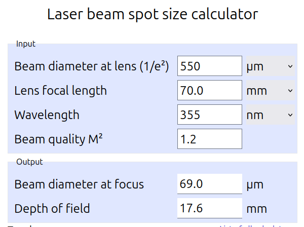

I have a 60W fiber and I’ve got setting down for a specific sized object. However when I attempt to enlarge or shrink it, the colors are not maintained.
I tried to see if I could figure out what the depth of focus (dof) this system has. I’ve used this spot size on-line calculator, but I get numbers that are a bit out of line.
Do my numbers look ok? One of the AI responses was a spot size of about 2 microns (0.0016mm). This suggests it’s 690 microns, which really doesn’t make sense to me.
If this is correct, you have a dof of nearly 18mm, kind of refutes the spot size suggestion.
A lot of basic information, I gleamed from the JPT site.
