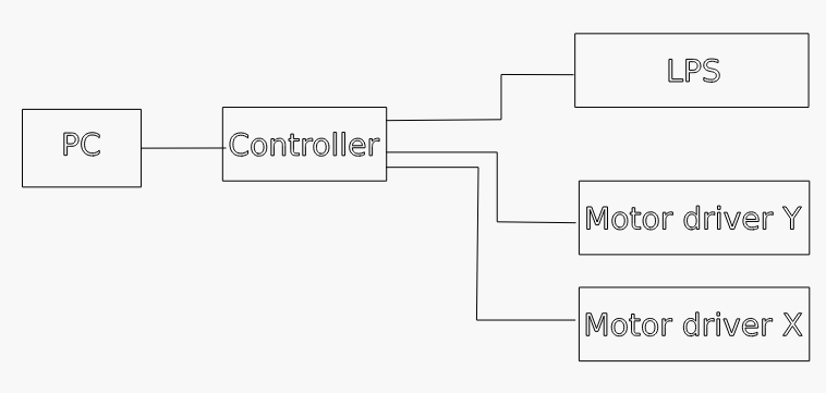

This is generally how these are built…
The 8515 is an Atmel (now MicroChip Technology) and is a micro controller… Not a driver… however I don’t have a clue as to what it’s doing.
