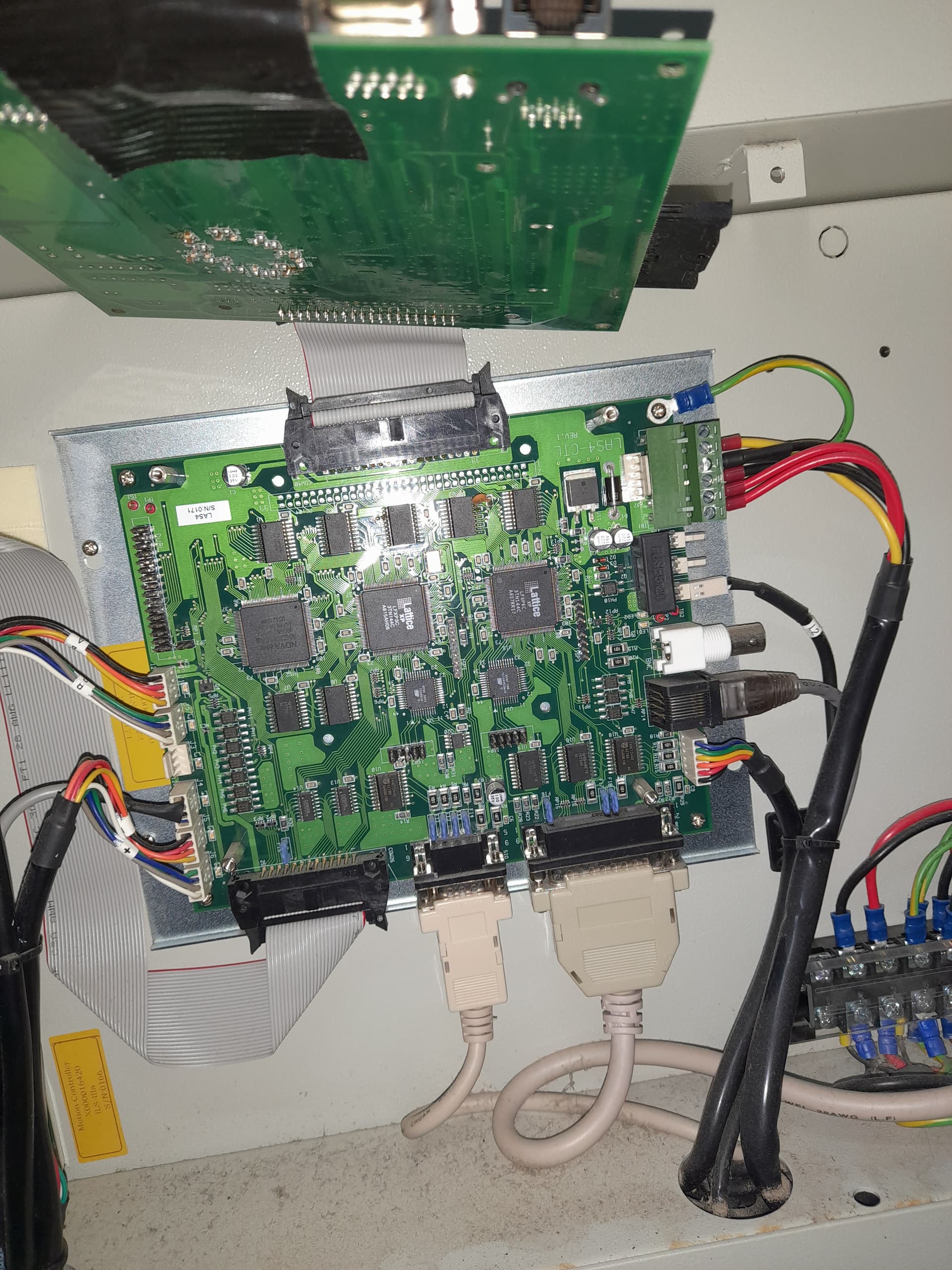

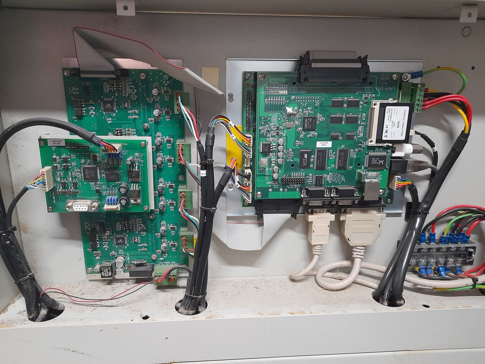

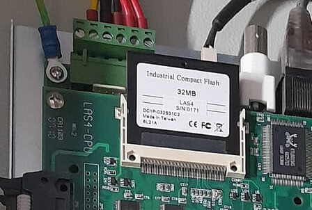

Mine has a FABIA FB2612 ver.1.5 LAS4 Mainboard with what appears to be a “daughter” board with RS232 ports, Ethernet controller chip realtek RTL8100C and there is USB 2.0 chip somewhere on the board.

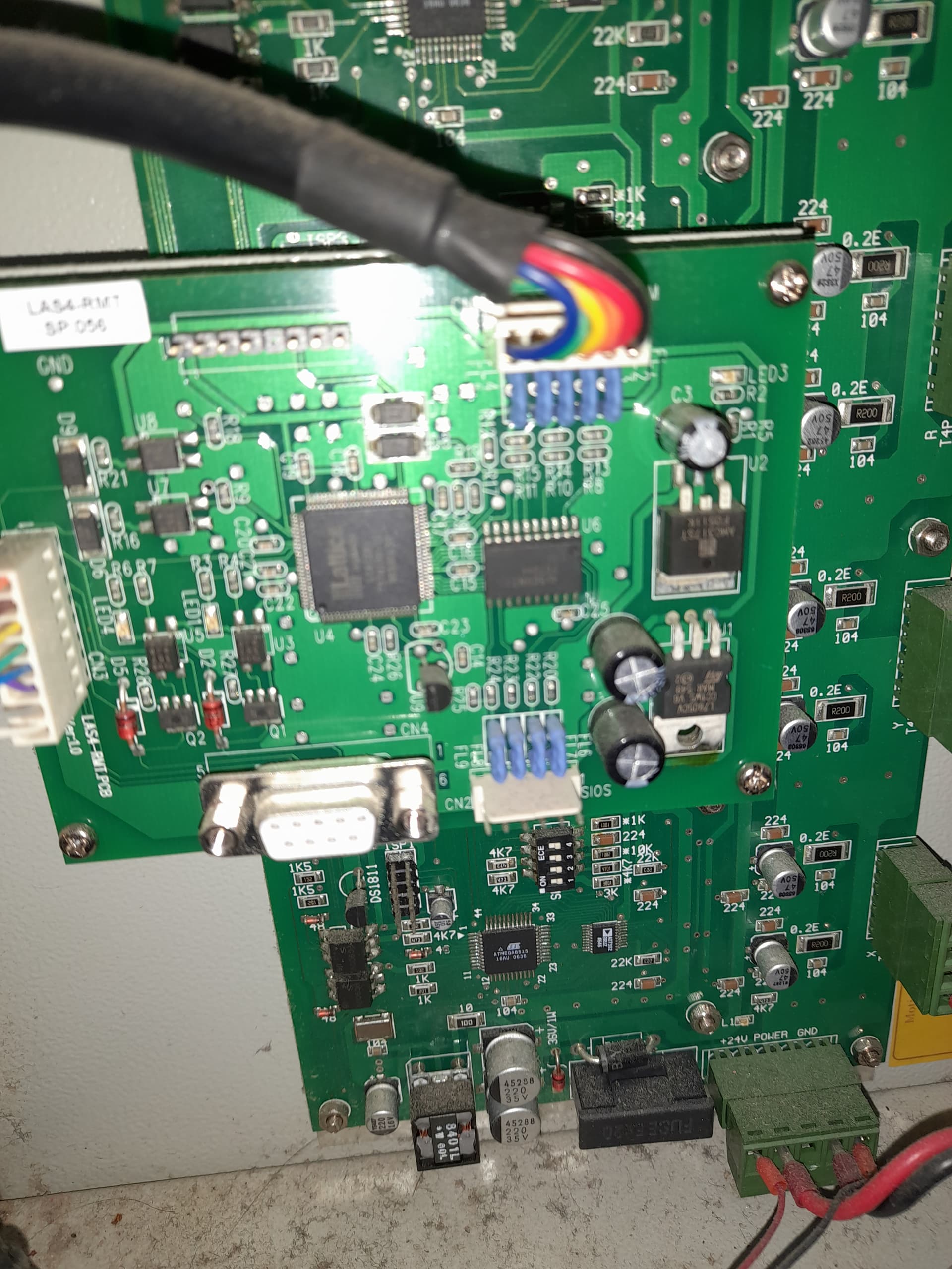

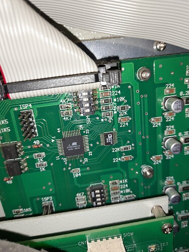

There’s a Motion control board upon which sit 2 x atmega 8515 chips (likely 2 more covered by another expansion board).
I have photos of the boards if they are of any use. BUT I don’t know how to attach them. This is the frist forum I’ve ever joined.

Drag the pics into this reply box. They should readily attach by doing this.
If this seems awkward, the Icon with the up-arrow pointing away from a horizontal desktop computer in the top row of the reply box is the Upload Icon.
If the controller is a GCode device, LightBurn 1.5.xx (still in development) may help get it going. If the controller is a DSP type, we may not have a workable answer (outside a controller swap).

stepper driver board to rear(i think) atmega8515 chips
atmega 8515
Mainboard on RHS (with comms board in front usb & network) Stepper board I think ? on LHS
the actual maiboard (comms board lifted away)
