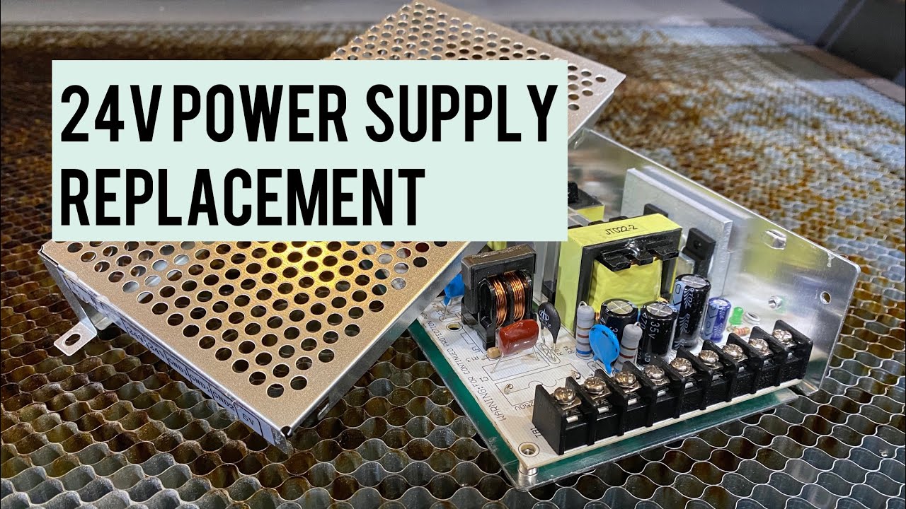

It looks like you’re not getting power to the Ruida. At the top of the photo is where the 24V go into the controller from the power supply, the low voltage supply (24V).
My 24V supply has a green power light on it’s board. The yellow arrows point it out…
Can you see if yours has a power indicator…

You should check the output of the power supply, it will be marked gound and 24V. It should read 24V…
If it does not read 24V change to an AC scale on your meter and ensure you have 120V feeding the supply.
If it has 120V mains supply, and no output, I’d say it’s a confirmed dead supply.

Jack, it’s me again. So I’m looking at the power supply and the 24v power supply, where do I check for power?
The connections are marked on the front of the supply. You can see how they are marked as generally there is a silkscreen on the board or a label indicating the connections.
Usually on the one side or the other is the ac input. Check out this < 10 min video on replacing it. Maybe you can see where the markings on your power supply are and the arrangement.

Well apparently it was the new E-switch install, took it back out now the LPS works. Do you have a source for a new 24v +5v PS? Only one i can find its only 24v but doesn’t have the 5v for the laser pointer. I’m just going to swap it out and be done.
You’ll have to look for one… When I looked originally, I wasn’t looking for one with 5v…
Some lps have 5V line available… Have no idea about it’s current availability…
