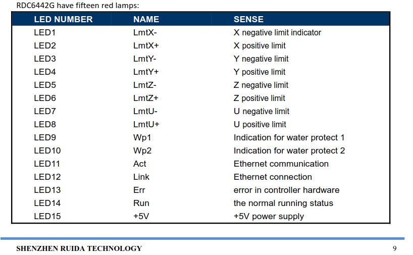

Does it boot? If you are controlling it and the number are changing, it either did a good boot or it didn’t. Was there an error message on the Ruida console?
If the lan connection isn’t working, I assume you are doing this via the machine console…?
The lan led lights when you have a hardware connection and the activity led flashes when data is transferred.

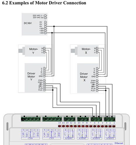

You can see here that the X and Y motor driver signals are on two connectors that are essentially the same… you can swap these and see if the problem moves to the other axes.
There is also a red fail led on the motor dirvers themselves. Ensure both have green leds illuminated.
Check the leds especially the err led. These led are pretty informative…

LED15 is lit up actually, for some reason I assumed that was normal (!)
That means there is 5V present within the controller. It should be on… My run led flases when it’s just sitting there.
