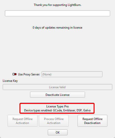

I bought LightBurn 3 or 4 years ago, when the choice was - license for a Ruida based controller, or license for Gcode machines.
I see the licensing is different now, with a core and a pro version, and upgrades on the website mention having “core”, nothing mentioning upgrading or renewing older versions.
I run the Ruida license with my CO2 machine, and no longer update since two years, I’m at 1.4. So to my question, is this old version now classed as the pro version? I will buy a Fiber laser, do I simply need to use the 'renew lightburn updates for one year" to my 1.4 license to get the latest version 2 and open up the fiber laser controls and settings, or do I need to both to renew and upgrade? thanks.
Hello Wells
The simplest way to see which license you have - now called Core or Pro - is to navigate to Help - > License Management
On Newer versions of Lightburn - the License Type is also stated.
However on 1.4 you can define your license by Allowed Devices.
If Gcode = LightBurn Core
If Gcode, DSP, Galvo = LightBurn Pro
