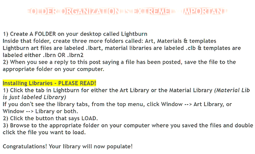

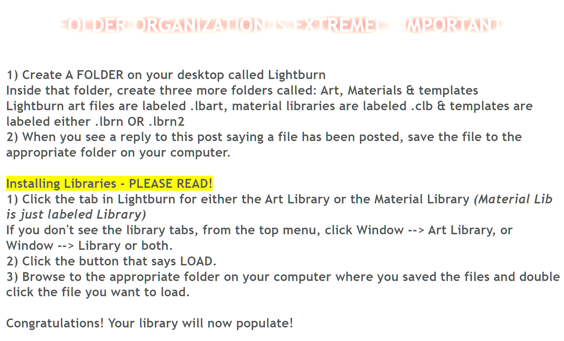

Just an hint on folder organization from LAHobbyGuy:
