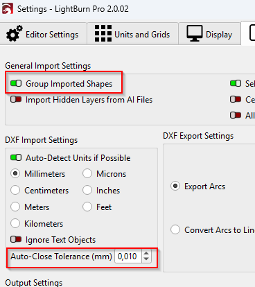

It turns out that rather than seeing the outlines as whole shapes, svgnest is seeing them as a bunch if indivdual shapes, one per line, and trying to nest those, which just results a dark blob in one corner of the material.
So what I need, somewhere between the image I see on FreeCad and hitting the svgnest “Start Nesting” button, is a way to have those shapes be recognized as complete shapes rather than a whole bunch of edges.

Do you have connected shapes in LB? If not, select all of your shapes and Auto-Join Selected Shapes.

  • All shapes are closed (and only then can they be recognized as individual parts)
  • All elements are ungrouped

To ensure my object(s) is a closed loop, I use the Fill mode on the object. When there are no gaps, it will fill, and not before.
Sometimes, I have to use Close Selected Paths With Tolerance instead. In other words, try the various choices with Fill turned on. Then turn it off when done.

Alternatively, selecting all your geometry and going to ‘Edit > Auto Join Selected Shapes’ may work for you.
You might also check out those options for importing shapes, maybe play around a bit:
