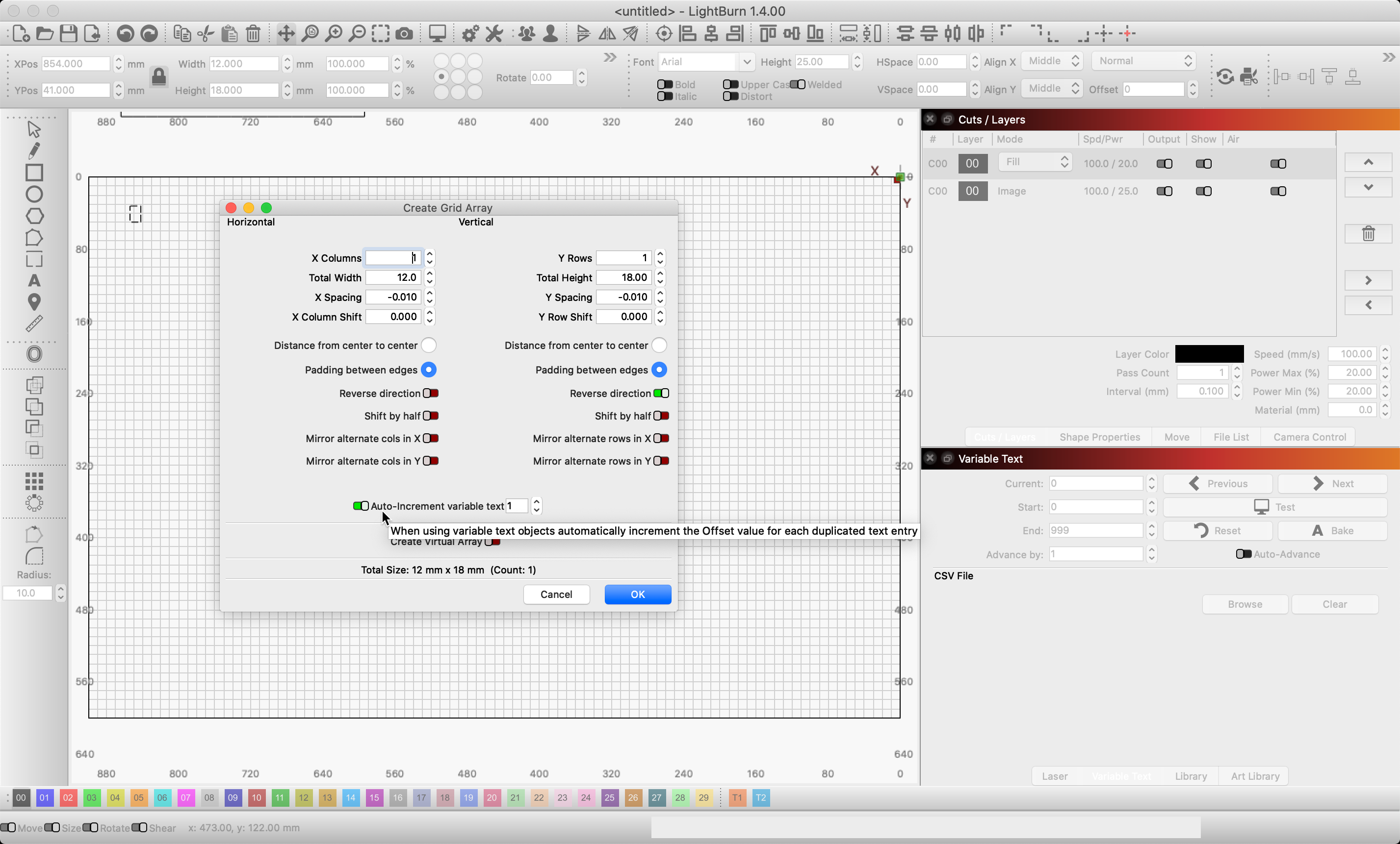

Is there a way to copy/paste inserted text?
I frequently have to use a list of names/text to insert into a variety of the same object. Basically do an array of a design and insert individual people’s names to personalize. Right now I’m having to jump out of Lightburn and cut paste each name from the source because I cannot reuse the text once it has been inserted into Lightburn. It’s a bit cumbersome going back and forth so often, would really be an advantage if there is a way of using text that is already in the program. Is there an easy way to do this that I’m missing?
You can copy entire sections of text but trying to extract a portion of a text field won’t work well.
However, based on what you’re describing this may be a good candidate for using Variable Text. This allows you to use a list of text as input to be auto-populated into specific areas of the design.

While we understand a few names can be managed manually, larger name sets can be automated to help save time processing these jobs. This is precisely one of the use cases used when designing the LightBurn ‘Variable Text’ feature as @berainlb suggested above. :slight_smile:
While I thank everyone for their input, I don’t believe that these suggestions will work for me. I want to burn the array of items at once and just work on the computer while it processes uninterrupted. I just need the ability to quickly cut text. Oh well, I appreciate the answers. Thanks all.
This is unquestionably doable using the Array tool or Virtual Array in combination with Variable Text. You define auto-increment of the names, so each object gets the new name from the list when processing or in Preview.
I’m sorry I didn’t fully understand everyone the first go. Thanks for sticking along with me on this Rick! Found a great video and it is so much easier than I would have ever thought.

Check this out, Rick kept pushing me and I’m glad he did. Popping into an array takes care of everything too. As long as you get everything into a CSV it saves so much work.
Figured this out, would not have thought you could use this in conjunction with Array. Thanks!!
