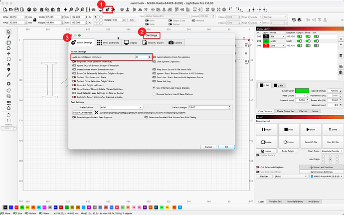

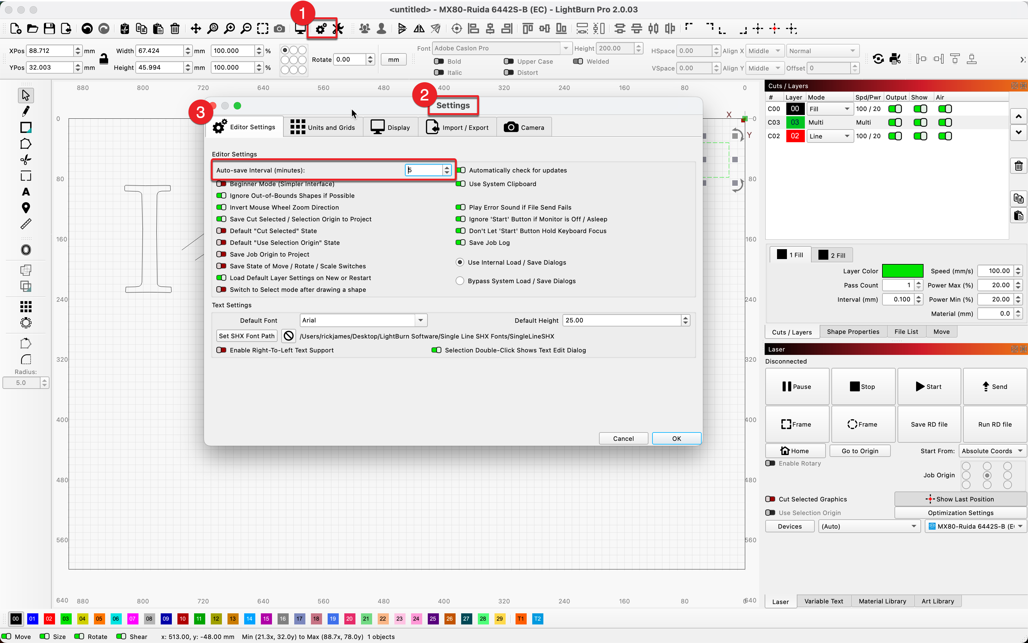

Can you share how to adjust this on Win/Mac/linux?
Absolutely, I should have shared in my last post. Apologies. :wink:
Auto-save Interval (minutes)
Sets the frequency of auto-saves, in minutes. Setting the Auto-save Interval to 0 disables auto-saving.
Auto-saves are stored in the same location as you saved the original file, with _backup appended to their name. If you’ve never named a file, the auto-save will be in your computer’s Documents folder.
Each auto-save overwrites the previous auto-save, and when you manually save the file, the auto-saved copy is deleted.
