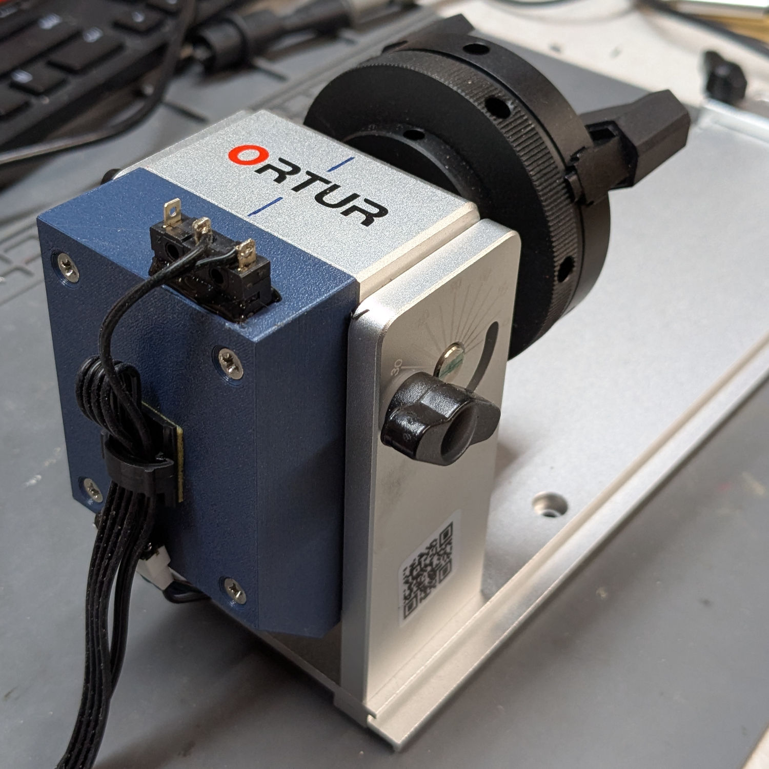

The complex way is to put a home switch on the rotary, then twiddle the Y axis homing configuration to put one of the key sockets where you want it. I crawled through that process with a little Ortur rotary on my OMTech and ended up with a checklist to ensure I don’t forget anything:

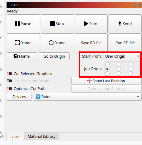

I do it this way, so it’s my opinion, nothing more. Set the start from and job origin as such. You also have to move the rotary where you want it and set the origin on the machines console.
This applies to both axes. If I have a logo or something else, I put the mug in so the logo or whatever is centered with the machines X/Y axes.
