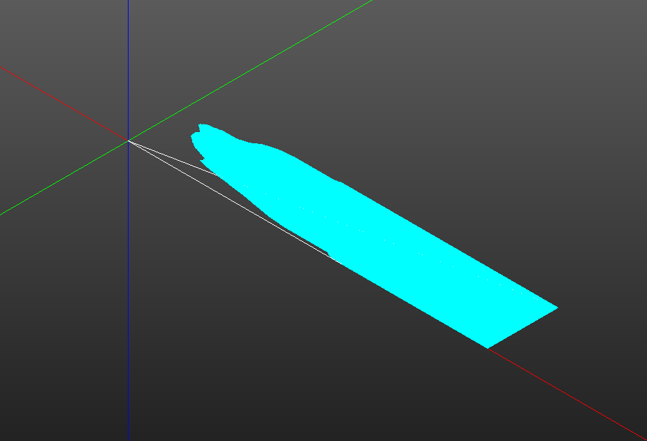

Willow New Image.gcode (3.5 MB)
It’s hard to depict the orientation of the project, but at least, it’s not starting at the origin. You might have an object outside or did not enable “cut selected graphics only” and “use selection origin”.
I do not think I have anything outside of the area, do have cut selected graphics selected and I will try it with selected origin and see how that works? Thank you for your suggestions.
Is there any difference in having a laptop running the file or a sd card running the file, the origin and framing should be the same?
I’d say, it SHOULD be, but you never know how the developers messed up the firmware. Try using a USB connection to check this.
