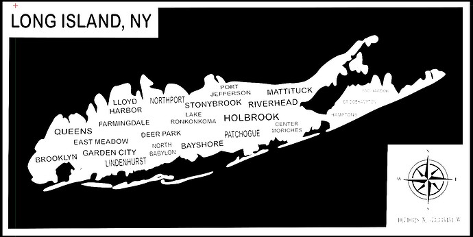

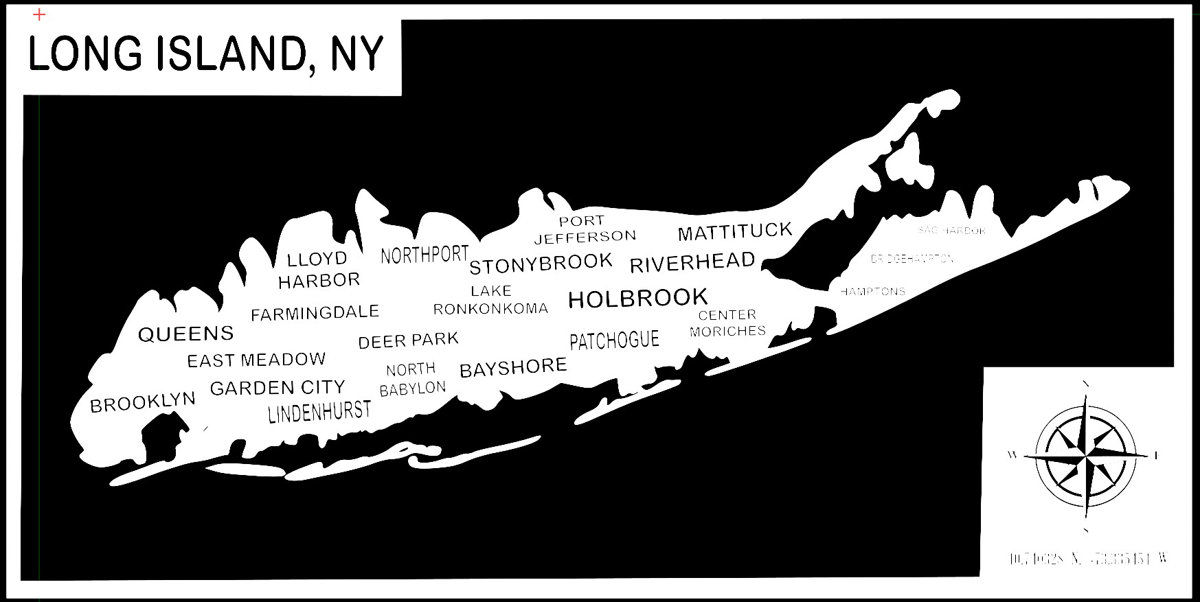

Digging the smallest text out of Long Island will require more care and perhaps different engraving settings than blowing away the Sound, so making two passes with a larger tube may turn out to be slower than a single pass with a smaller tube.

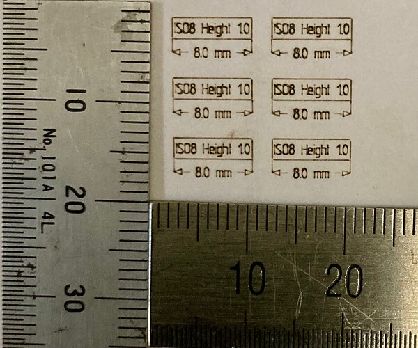

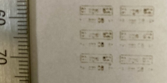

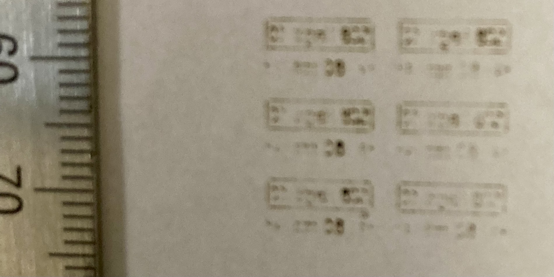

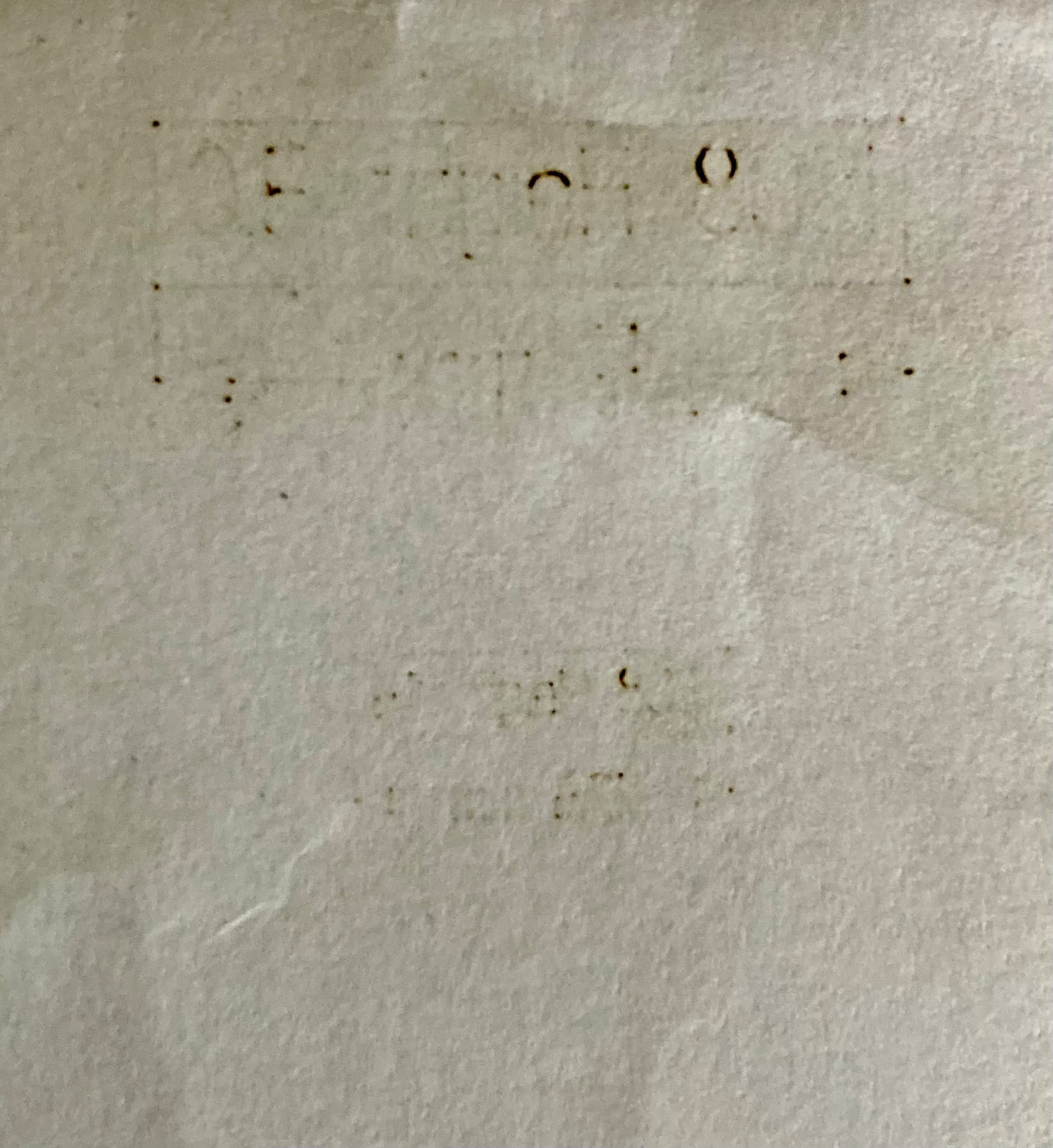

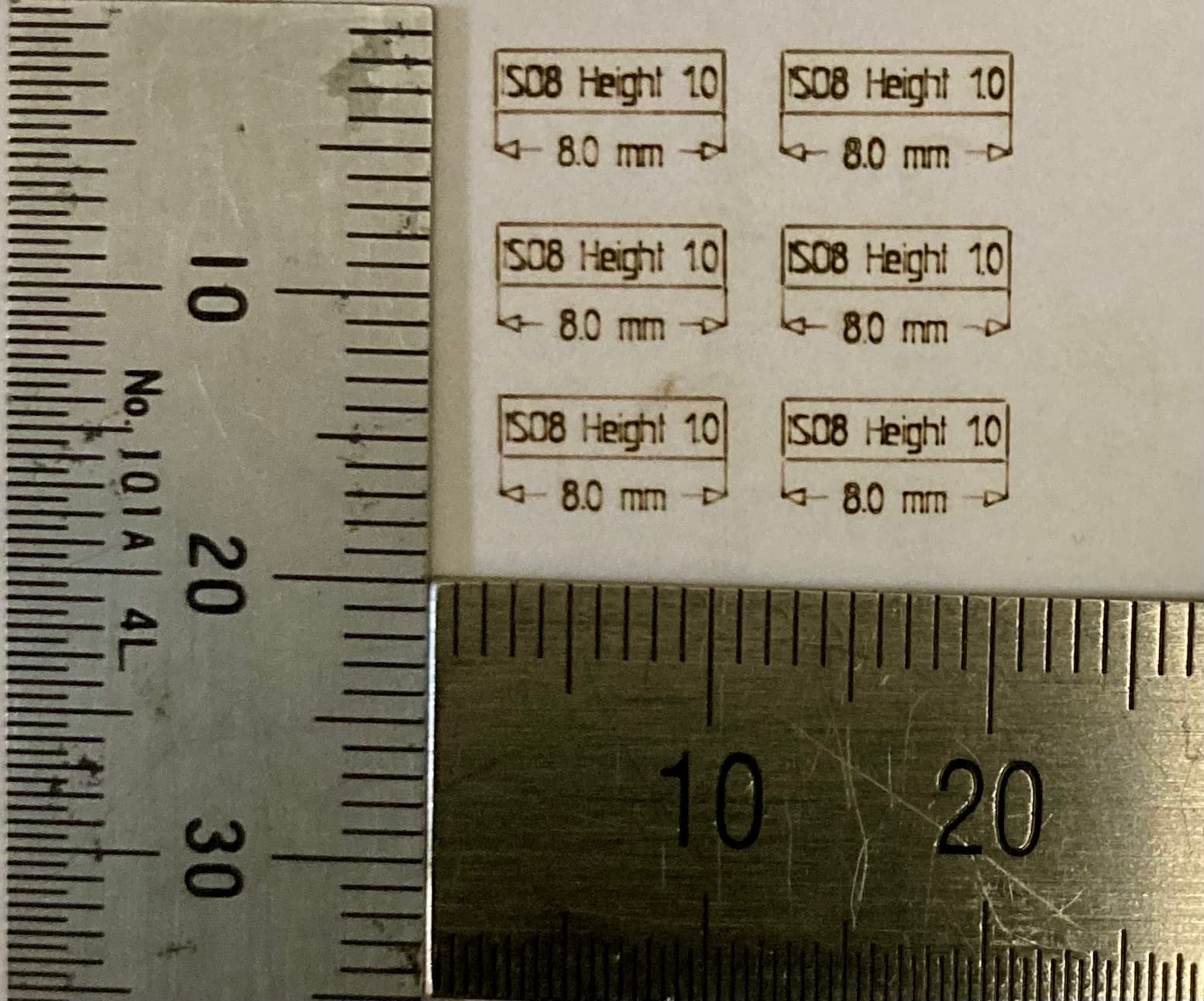

A small example of what is possible (with my 60W CO2).
The pictures above are the back of the paper (usually letter paper), which shows the penetration of the laser, power and focus could be worked on a little more. But on most other materials I can engrave, down to 1mm so it is still readable.
PS. My machine can “turn on” all the way down to 8.58%, don’t ask me why.

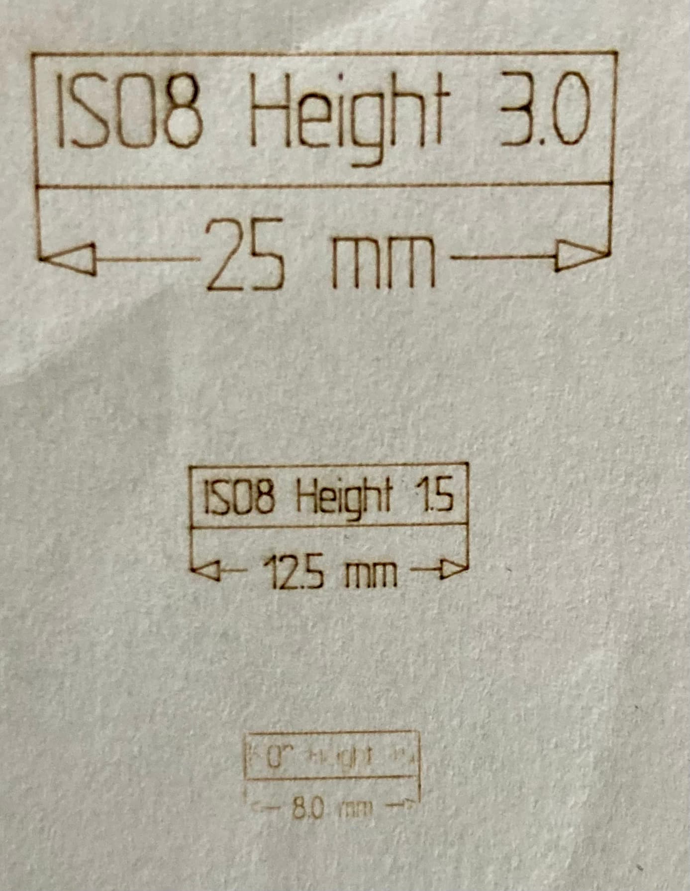

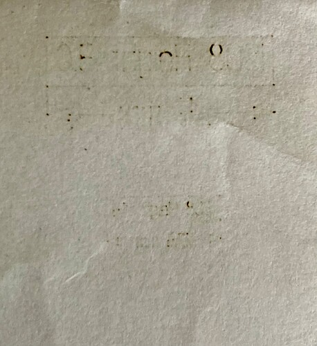

Work out the spatial period of the PWM.
A 2" lens has about a 0.13mm focal spot size according to optics diffraction rules- the actual mark size can be larger or smaller.
Let’s say the line is still going to be a contiguous cut as long as it turns on/off within a FSS of travel. At 300mm/s, that condition would be met if for PWM>4.6KHz.
