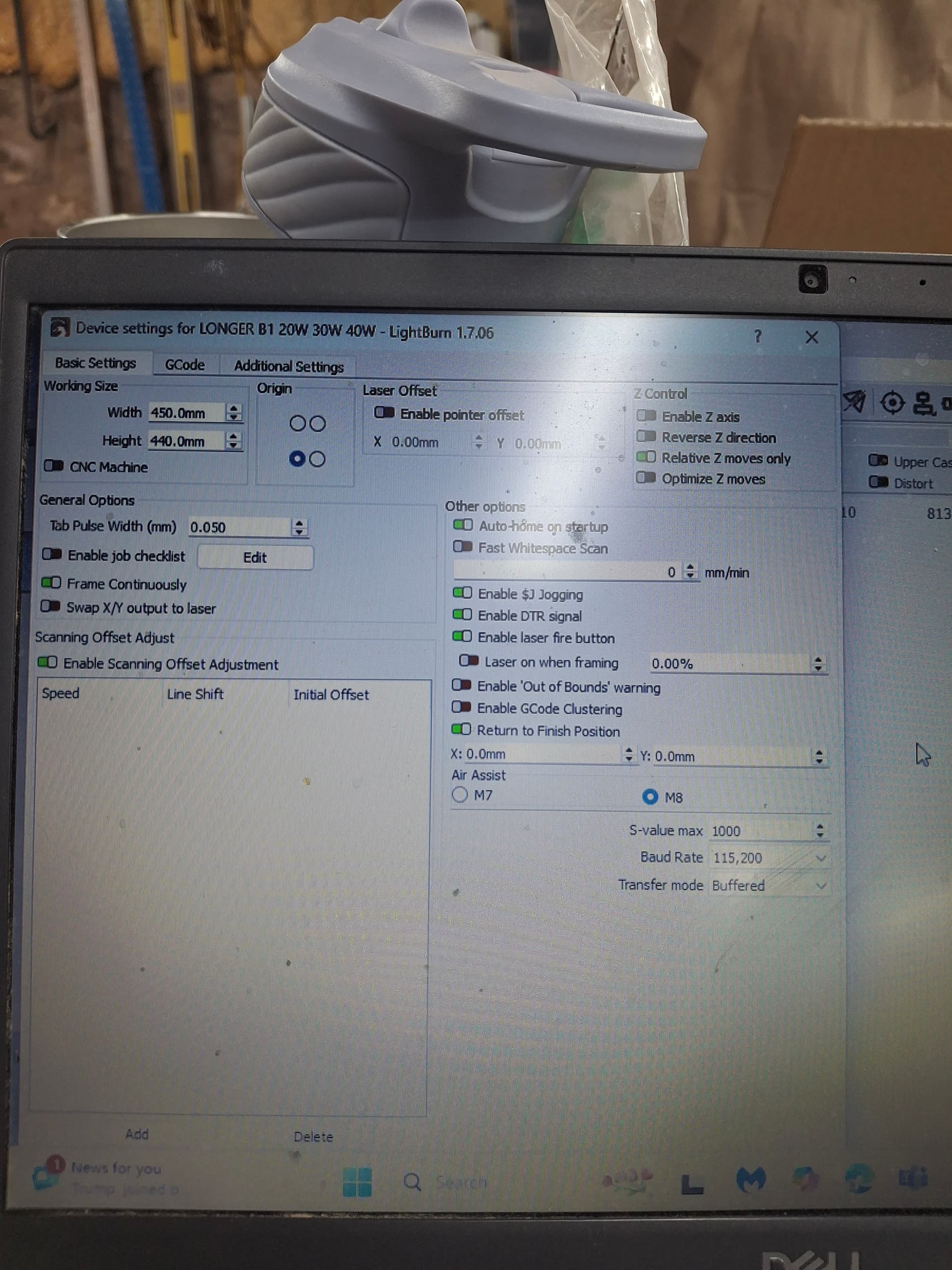

Heres a picture of my device settings and what it looks like when i try to frame.
Disable DTR, power cycle the laser (power and USB) wait 30 seconds and try.
Also the laser have something that triggered a check.
Akso disable scanning offset you don’t have any values there.
Disable continuous framing as well. Then you will have more control to test it. Turn on laser on when framing and set a percentage. Turn off return to finish position. Diable auto home at startup. All those functions will lead to unforeseen movements. You can turn them back on if you really need it.
