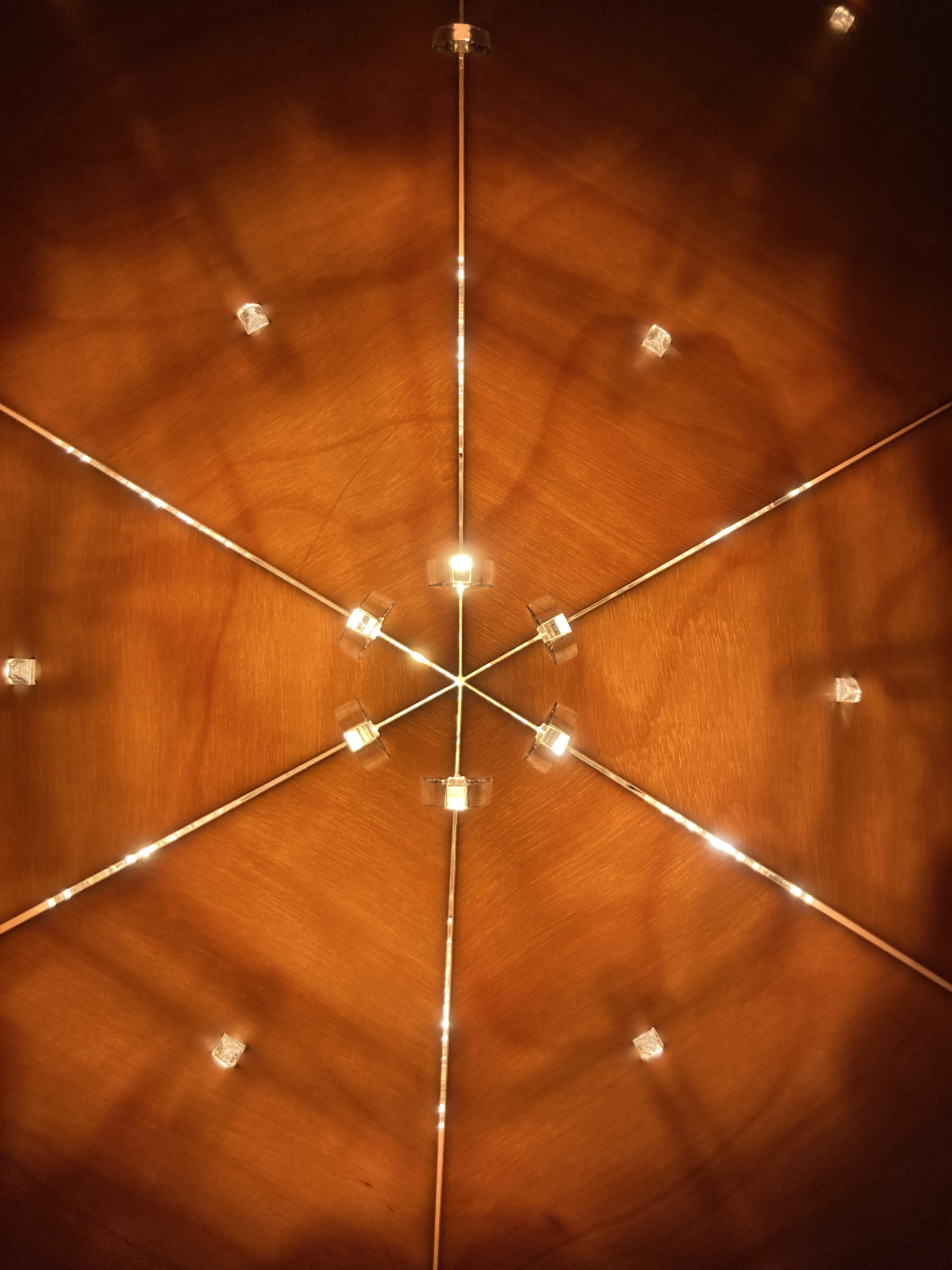

Power also does not really help with poor quality. For lamp production I typically use 3-layer 0.4 and 0.8mm B Baltic birch. You can see through the layers, that’s why I use it. If there is a glue pocket or knot, the area when cutting is black and charred and does not burn cleanly through - useless for my purpose.
