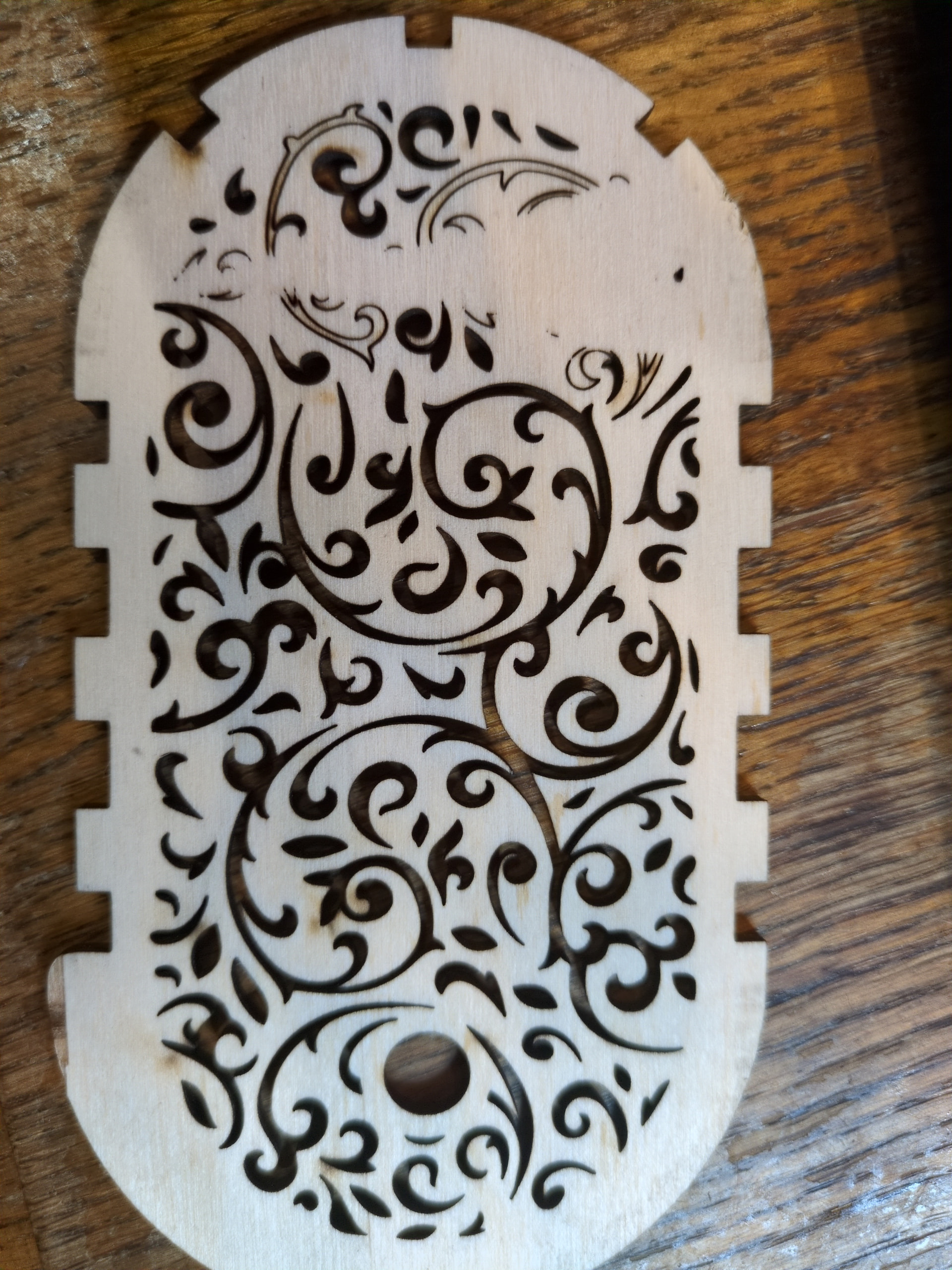

Unfortunately, I produce a lot of trash like shown on the picture below. This is a work piece from the bottom. As you can see, 90% cut outs are even and not burned. The small parts easily fell out at once, or at least with very litte pressure. This makes me beleive, my laser settings (focus, heat, speed, air assist) are OK. Beside that, there is an area, where the laser did not cut trough, and was not even near to do so. No chance to rescue anything with a cutter blade.
I now learned, all layers in the middle of baltic birch are pure veneer instead of soft glue-wood mixture, that make the core of many other plywoods.
Would you agree, that this failed areas are caused by a veneer sheet in the middle of the plywood, that is extremely hard?
Anyone of you using this material? Do you face similar problems?
Any ideas to avoid this?

It is more likely exterior glued plywood or veneer of non-laser grade. It is a known issue, you should look for laser grade plywood, interior glued.

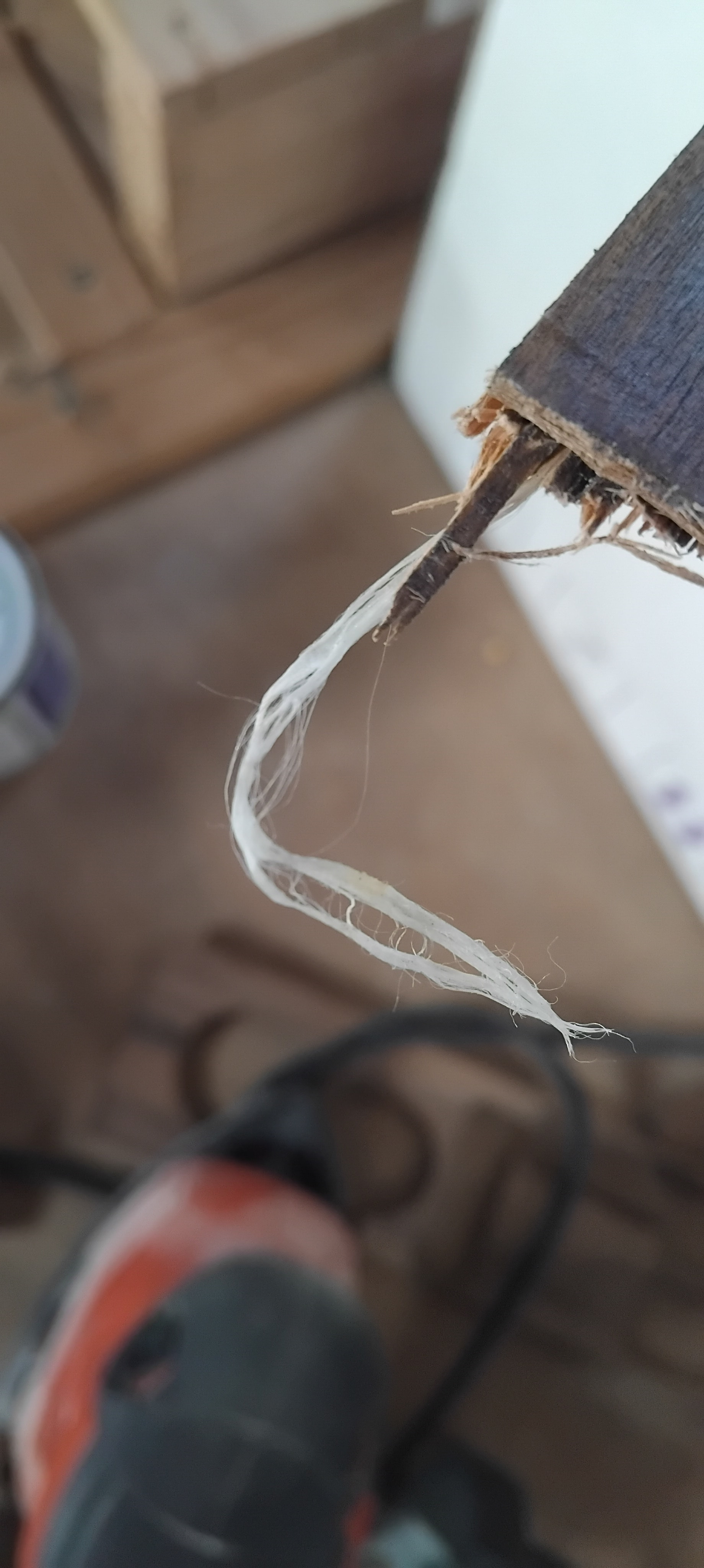

Here you can see the difference between the two types of glue.

It could be a number of things, none of which you can predict or control. The solution is to add 1-2 passes to the cut.

Hi … I have discovered that most of the Baltic Birch they make now have a lot of voids in the middle layers …. the way to determine where the voids are is to use a powerful Light and hold it behind the plywood and you can see and mark the plywood to avoid cutting in that area.

What you show in the picture has nothing to do with “laser-suitable”. You just have to recognize/accept that you can’t cut this waste wood properly with a normal CO2 laser.

Can you specify which glues this are? Is this the difference between waterproof or interior plywood?
WBP glue, it is a water-resistant glue (typically phenol-formaldehyde or melamine-urea-formaldehyde) for exterior use (that’s the black charred disc)
MR (Moisture Resistant) glue in interior birch plywood consists primarily of a synthetic urea-formaldehyde resin (UF). It is a thermosetting glue formed through a chemical reaction between urea and formaldehyde - it’s the nice bright slice.
