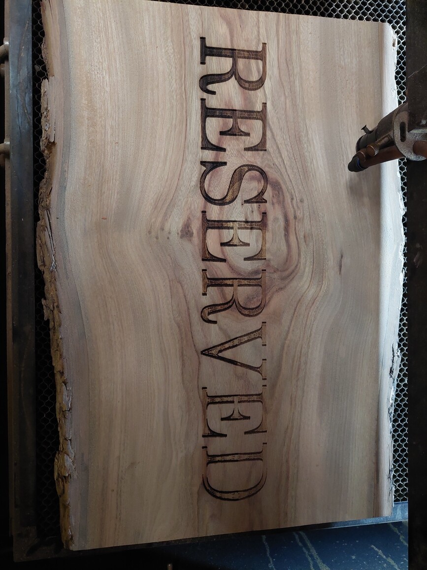

Hi Everyone,
I have been away for about 3 weeks, before I left my laser was working fine although perhaps with a decline in power output. The laser has been sitting unused during that time, and when I got back today, it was not working properly. I tried a raster engraving and it appears to only engrave the edges of the letters, like it fires but quickly loses power after about 2mm and then after it is turned off and on again by the controller it works again briefly but then fades rapidly. (see attached images). Am I looking at a failing tube or is it more likely to be something else?

Do a good look to check the mechanics are ok then you have to check alignment/optics.
You need to ensure it’s not one of the previous issues, mechanics or optics. I’d suggest you start at m1 and go through the machine.
Since it’s a relatively acute failure, it doesn’t sound like a tube to me. More like an lps. If it’s been slowly failing, then an increased probability it’s the tube.
Do you have a mA meter to see what kind of current it’s running?
Ensure that it’s running in TEM0 resonance. You check it at m1, where the beam comes out of the tube… should be first step in alignment, m1…
Good luck
Looks like an alignment problem.
Doesn’t look focused. If this is as good as you can do then test fire into wood just off the tube and post an image of the burn pattern.

I went back and rechecked the alignment and focus, everything looks correct.
Here is an image of the test at the first mirror, right out of the laser tube. Does this mean that the tube has a mode failure? The power output seems a lot lower, usually a instantaneous pulse leaves a solid burn mark, while realigning this time I had to hold the button down for a second or so to get a decent mark.
Further update, I tried a test with a lower power and at lower speed just to see what happened, and it seems to work a lot better at the lower power setting.
Could this mean it’s a power supply issue?
80% power, 300mm/s
40% power, 150mm/s
I think your tube is history… sorry.

No… I’ve never see this problem resolved by another lps.
Did a power supply cause the tube to fail? Might have if it overpowered the tube. But that’s a pretty large tube to overpower. Could be a defective tube. How old was it? Could have run out of water? Temps got too high during the previous session? This tube needs a compressor style chiller.

The tube was about 2.5 years old, it is a RECI W6 130W (genuine according to the QR code), it possible I could have overpowered it, I have noted the power supply was for 150W, the max I have run the duty cycle at was 98%, usually 80% or lower however. If my calculations are correct, a 150W power supply can put out 35mA current at 100%, and the W6 tube is 28mA max, 26mA recommended, so I should have been running max 80% or 74% normally, is that correct? Or does the tube only draw what it needs?

You could have over driven it, especially with a larger supply than it needs… This is not a ‘bad’ lps, it’s more like it’s larger than needed.
My machine was an advertised 50 watt China Blue, that measured 44 watts and has a 60 watt lps.
The tube current is limited only by the lps. When the tube lases, it lases at 100%. If the tube limited the current you could not ‘over drive’ it.
My tube is rated at 21mA, when I tested it at 50% power the current draw was 14mA. Conclusion - when my tube lased it was drawing 28mA.
I set the pot in the lps down so it would draw 10.5mA at 50%. Now it lines up with Lightburn percentage and limits the correct amount of current. I think it does have a faster response time, it would have to be quicker for a higher wattage tube.
