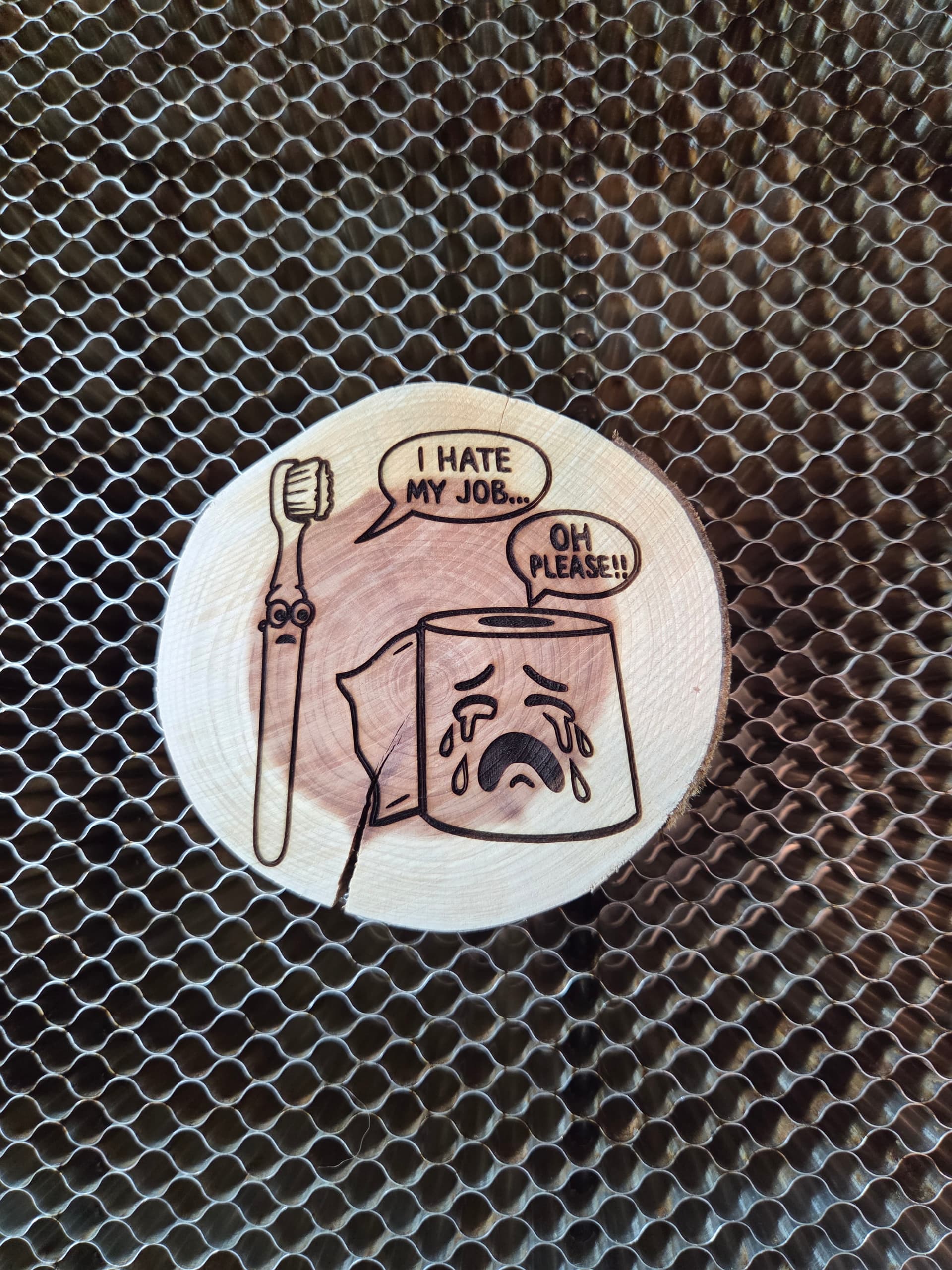

I have a question about Lightburn 2.0.00 thru 2.0.03.
I am currently using a AlgoLaser Diode Laser 10W and use the paid versions of Lightburn.
I installed 2.0.00 when it was available and it run fine for about a week, then when I tried to engrave a project using Offset Fill, I noticed that the laser beam started the project fine then about half way through design the laser beam shut off but the laser head continued finishing the design.
I have checked everything that I know to do, and I could not fix it. So, I uninstalled 2.0.00 and reinstalled 1.7.08 and my laser worked great on the same project which I believe will eliminate that it might be my laser machine.
So, I waited until I saw the 2.0.02 (I did not install 2.0.01) was out and installed it. But the results were the same after a week or so of use. So, I uninstalled 2.0.02 and reinstalled 1.7.08 and there again it works great.
Then I saw that 2.0.03 was released and installed that hoping for the best, but with the same results except this time not only did the laser beam shut off in the middle of using the offset fill mode it also shut off when I tried to engrave a different design in the line engraving mode.
So, I am back to using 1.7.08 version, but would really like to fix this issue because I do like some of the new features in the 2+ versions.
Note: I have the up to date Window version and drivers on my laptop and I shut down my laptop everyday.
Thanks for any suggestion in solving this issue.

I reinstalled 2.0.03 and made sure that it is running gcode also I clicked on the “Emit S value with every G1 command” button and the laser is not on constantly. It only comes on when I run a project.

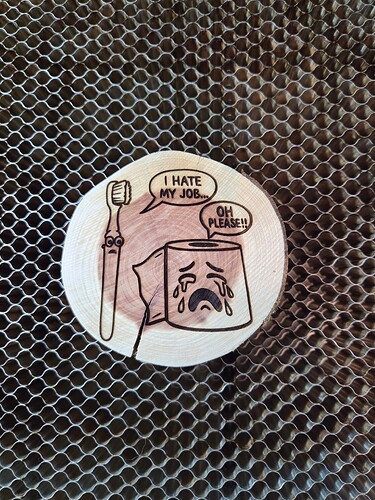

Hello,
I ran the project that I had the issue with when all this started and it burned just fine.
Not sure if just turning on that G1 command helped or not. But it seems to be OK right now, running 2.0.03. I’ll keep an eye on it.
Thank you very much for your help.
