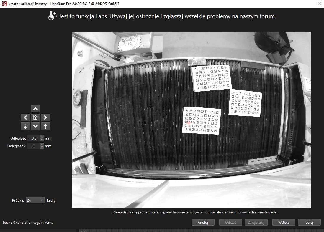

I’m using LightBurn v2.0.00-RC8 and running into a problem with camera calibration using AprilTags.
Due to the distance between my PC and the laser, I’m using VirtualHere on a Raspberry Pi 4 to connect the camera over USB remotely. The connection itself works flawlessly — the camera is detected and works fine in LightBurn.

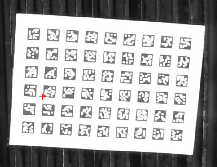

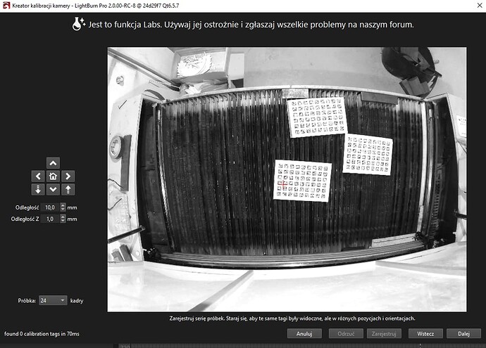

However, after switching to a UC60 camera, I noticed that AprilTags are no longer detected, even though they worked perfectly with my previous cameras. I’ve tried moving the tags closer, farther, changing lighting conditions — no improvement. The software just doesn’t recognize them.
Even the alternative camera calibration method fails to detect the tags on this camera.
