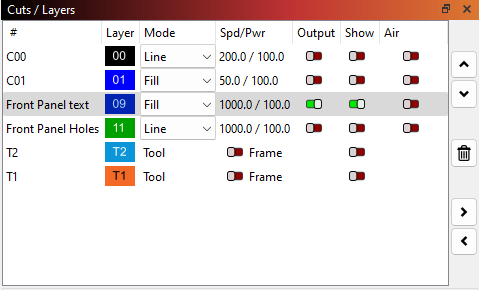

I have run into a problem that I can’t seem to fix. I have a project with 6 layers. as shown here:
2024-05-03_10-47-40
When trying to add text or any object to the layer “Front Panel Text” , the object I’m trying to add goes into layer C00. Tried cut/paste from C00 back to front panel text fill layer, but it still goes to C00.
Thinking I have a setting wrong, but can’t spot it. Thanks in advance for your help.

When you have the object you’re trying to add to layer C00 selected, can you change it to the same color(09) as Front Panel Text by selecting the color from your palette? That is another way to assign an object to a layer, simply by changing the color.

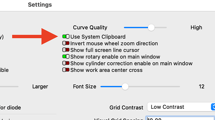

Have you enabled ‘Use System Clipboard’ in your settings?
Thanks Jess. When I closed and opened Lightburn, layer actions worked as expected.
