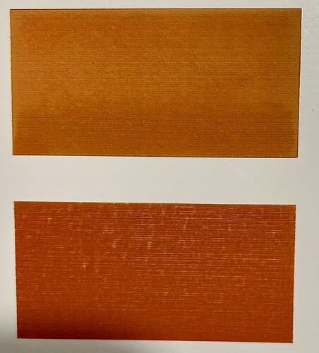

Most co2 machines have about a 0.20mm spot size with a 50.8mm lens (2"), so you might want to try an interval of around 0.20mm (127dpi) as a start for scanning operations.
I have the same controller and it is not upgradeable, just like @jkwilborn writes.
On the statement about the spot size in the same post I can say for my machine that it has, with the mentioned configuration, a smaller spot size.
In the picture you can see a line spacing of 0.2 and 0.1, in fact you can still see a clear demarcation between the lines even in the example with 0.1 LS.
So when I engrave images I am not above 0.1mm LS if I want the best result.

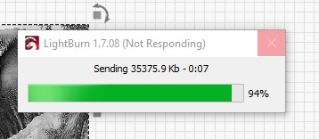

I have just carried out another test by pressing start on my laptop with out the machine in the ready state.
Here you can see the transfer progress and size of file. it got to this point, and lightburn stopped.
The controller had the error message (open cover protection work paused), which was not the case as all covers were closed.
So it seem even with the machine in a non ready state, yellow light to green start state there appears to be an issue.

This was the larger file.
Your 2nd question
I used the start option
That tells me you should use the send function for larger files. I use send for all but the simplest jobs on mine. Have not had any problems. I have heard of others having issue with using start, which is why send is the recommended choice.

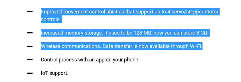

I guess they heard your wish, a new controller upgrade from the 6445 model.
