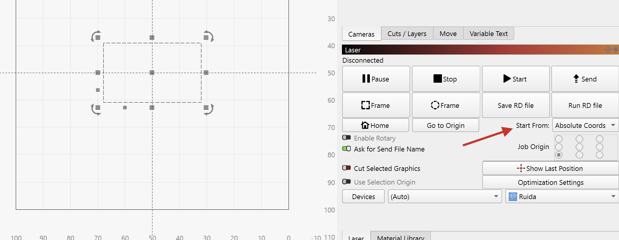

“Send” and “Start” transfer files to the controller differently. Does the red light show when using both these options?
To rule out an out of bounds warning as the cause, try to “Send” a simple rectangle to the laser.
Place the rectangle in the middle of the workarea and select “Absolute Coordinates” as the Start From value:

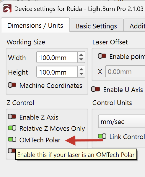

Bonus suspicion:
On the Polar, you should enable this option in the Device Settings. Can you confirm that it’s turned on?
It turned on
