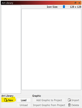

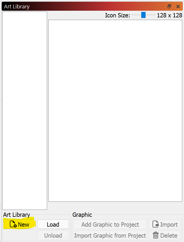

Make sure Art Library window is activated by going to Window->Art Library.
Click New in the Art Library window.

Clicked NEW in the Art Library but all that wants to do is create a new Art Library .lbart file. I already have an 01.lbart file which I created to see if that would fix the issue but no-go. I loaded and unloaded that file a couple of times into the Art Library palette (unloaded at this point).
