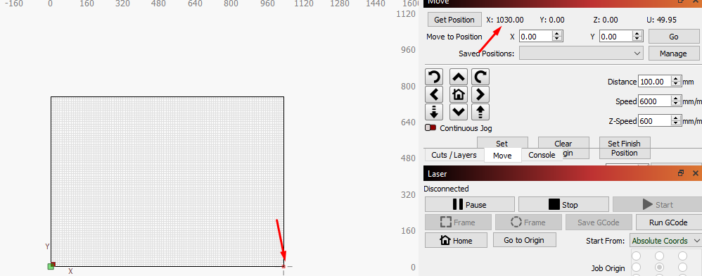

When I press the “HOME” button, my Neje Max 4 laser with an extension moves to the correct position (bottom left), but the coordinates show that the X-axis is at 1030. Why is that? How can I fix this problem?

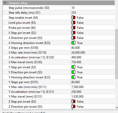

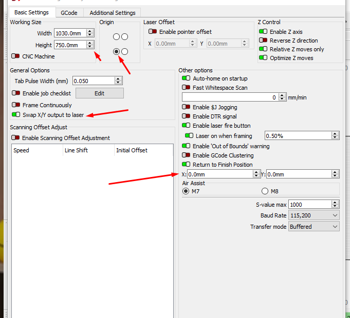

If you disable swap X/Y output to laser in your device settings, are the coordinates correct?
now its all good
