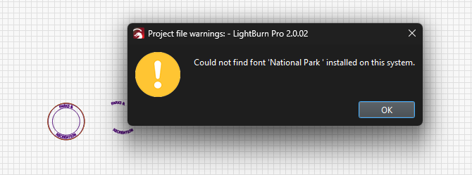

When opening certain older files we are running into some issues. Initially this message is provided. This is not specific to this font, this is just the project that is next in our que. Also this font is installed on this PC and the other two I am testing these files on.

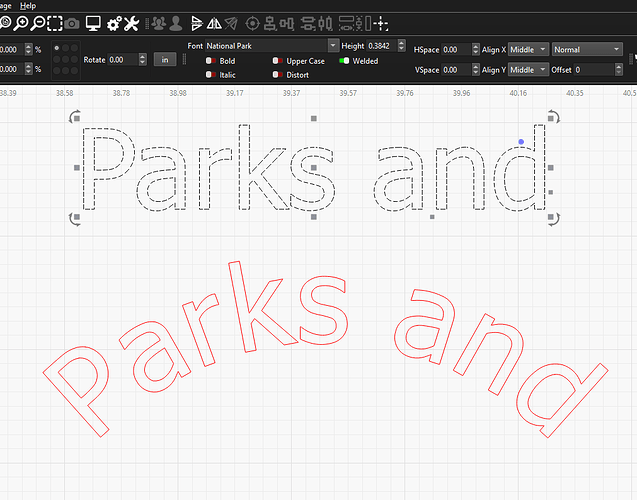

Once loaded we are not able to change the text. It will let me select text and change but it does not update the font on the screen or provide any of the text editing functions.

If the font is not available the text will be shown as a path and not an editable font.

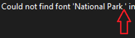

Admin pointed out the space after the font name in your screenshot.
Definitely could be the font was not installed correctly. Try adding the font again and see what happens.

The font was installed on all three PCs that I tested the file on. To be thorough I deleted the font from the folder and installed from a fresh download to this laptop. It did not change the symptom, before and after I get the same message.
If I create a new set of text in this file it acts normally.

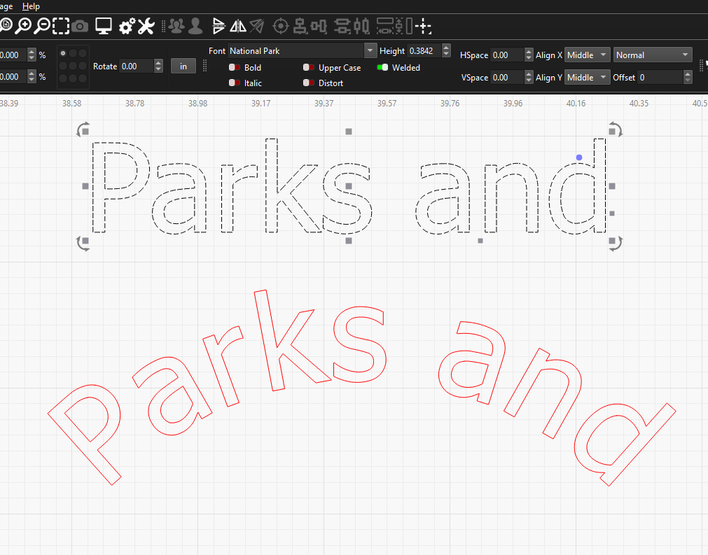

If I double click the bottom text it switches to the text editor as if it is text but will not allow me to modify it. Also if I highlight the bottom text and select the Nodes Editor it shows no option for grouping or ungrouping and no nodes are visible.

I’m going through file by file and so far it seems the issue is limited to files created in v1 and using the National Parks Font. I was told other fonts had the same issue but I can not recreate that issue. If I open the files in v1.7.07 it functions without issue and if I create a new version using v2 by importing the SVG and typing out using National Park Font in v2 it seems fine. So for now we will keep one of the computers at the older version until we can convert all the files over.
