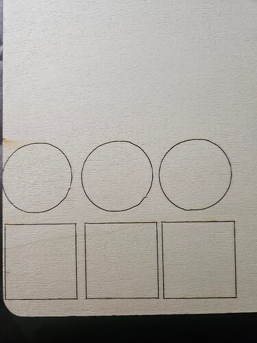

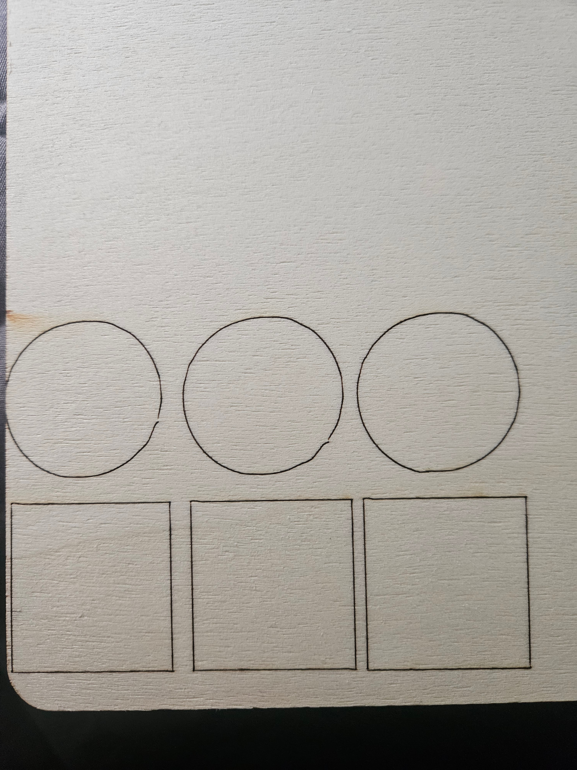

Now after tweaking those things I have what hopefully is also a minor issue. I’ve done a series of circle and square tests and at this point not sure what to tweak. My squares are a tiny off at the corners ans the circles are not quite smooth.
Am I looking at solely a belt issue and if so how do i know which to adjust?
Thanks!!
Hi Scott,
If you recall the diameter/size of the circles and squares you cut, measure them with a pair of calipers. Generally a loose belt will make a cut smaller than the intended size on the affected axis. So if an X axis belt was loose, and you etched a 1" x 1" square, you would measure less than an inch on the X axis.
Your image suggests a backlash issue. Check all the pulley and coupling set screws.
Does backlash suggest being too tight? And by set screws, where specifically? At the wheels? belts? Sorry I’m still learning my way around it.
I added an image to show what I’m experiencing not. Corners not crisp on squares and circles not crisp on the circumference with more of a wobbly line than a oblonged shape
Backlash is when you have a reversal of direction, but due to looseness the pulley has to rotate slightly before it grabs the shaft. Google “what is mechanical backlash”.

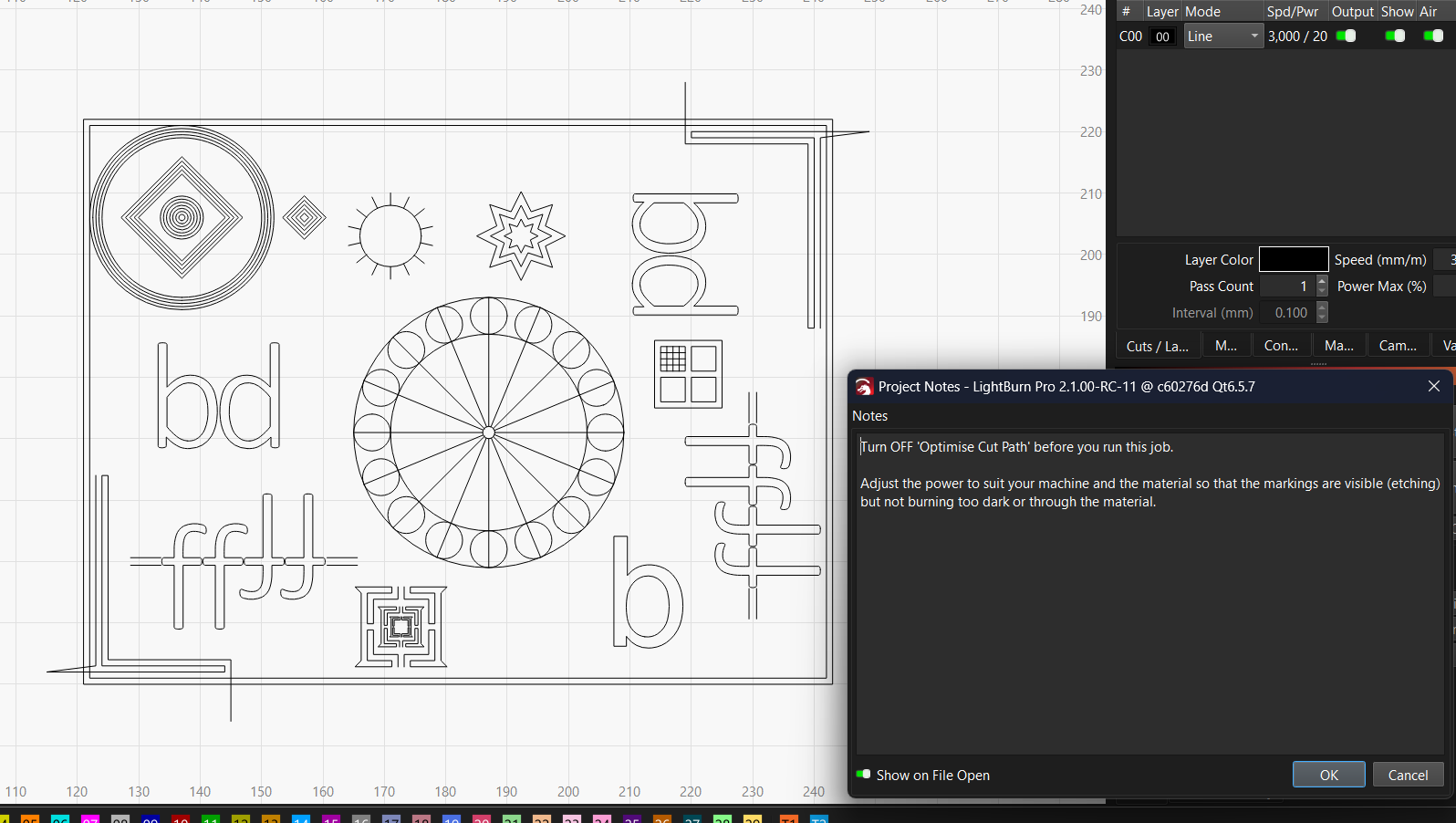

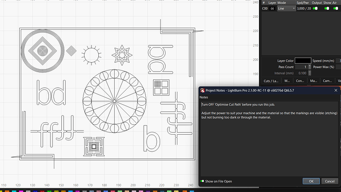

I recommend you run this attached ‘BacklashCheck’ before you make any mechanical adjustments so you can track how those adjustments affect the results.
BacklashCheck.lbrn2 (77.8 KB)
