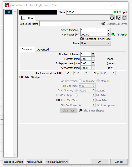

My father and I got a “Fox Alien 4040 Masuter” and a “FoxAlien 20W fixed focus laser.”
Got the Air assist so we could cut but we haven’t been able to cut more than 2mm of plywood/MDF.

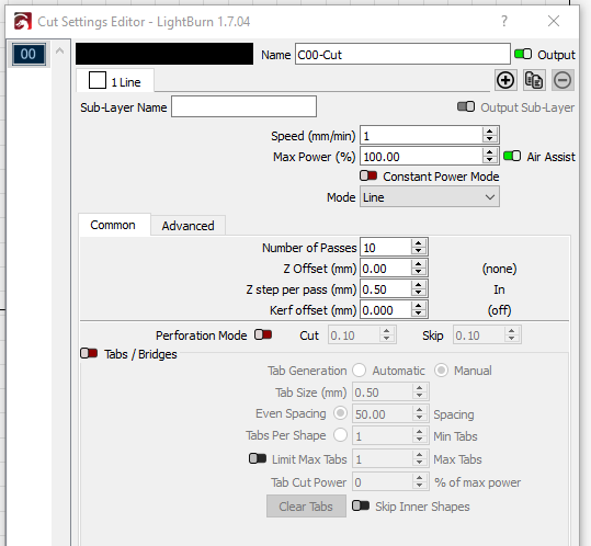

Just the last try before we gave up at 1mm 100% power with 10 pass…
Starting to think we just didnt get enough of powerful laser to cut, till i saw this.
I have to be doing something wrong, we have been setting the focus to 30mm.
My dumb *** cant figure this out…
Just wanna cut out my keychain.

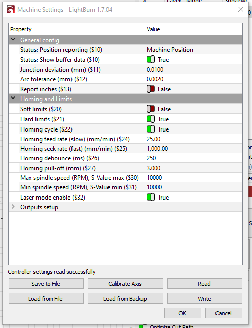

My $30 is the same as my S-Value.
The $31 is also 10000. It should be zero. This could be confusing the controller.
Changed this and wrote to the controller, thanks I just ran a quick test in the shed.
Still looks the same. The laser is barely getting thru the first layer of plywood.
Seems to be a focus issue but it is set at 30mm.

3,4,5. I am running this cut at 1mm 100%
This cut is only cutting about 2mm.
With a 10w laser, I cut 2.8mm ply at 800mm/min, 85% power, and 5 passes. More passes seems to work better than a single pass. Also, having Air Assist makes a big difference. You might investigate if that is an option for your laser module.
Is this your first project with this laser? Have you tested it on other materials, or did you start with this?
Bought it initially to in engrave have had not issue what that, but I should able to to cut.
I have a air assist with the nozzle which is on.
I’m doing test cuts at 1mm/s 100% 10 passes.
