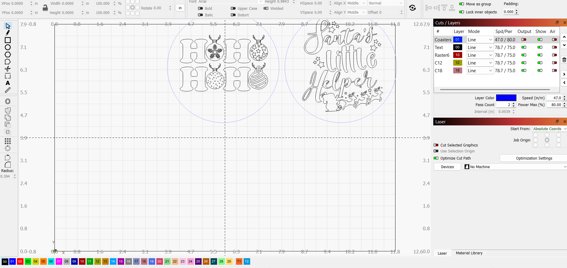

Hi Tim. Thank you. I did not know that. Here it is. I did the reset and I used the bundles to move all my settings to the new PC but I get this when I load a file and my Laser, Move, Cut/Layers and Material Library tabs are missing and the file loads into the extyreme upper right and I cannot move it.
I see a couple things here. First, it looks like you’re on a laptop with low screen resolution. You will need to adjust windows to make it work. I’ll link a video that should help below. On my laptop I have to have all the windows single stacked because of the screen resolution.
Second, you have no machine selected. Do you have a machine?

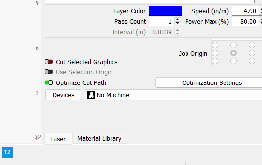

Thank you for the advice. I made the resolution and scaling on the PC match the old one and that seemed to fix it. I then did the export and import of the bundles but I still not not have certain tabs in the right side. I am still missing Move, Cut/Layers and art Library’s. Not sure how to get those back. I also have not yet plugged it into my laser. See Below

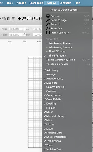

Go to window menu and make sure those are checked.
After I wrote to you i did discover that. I also followed the info in the video you sent. So I have them all layered now however I still have an issue where the windows do not look the same as they did with the old PC. They seem to be missing information. Do I need to connect a laser to fix this? This has really been a struggle. When I got lightburn for my old Laptop, it was just run the install sand everything was ready to go. I do not think the bundles is working because I have I still do not have anything in the material library. So I am concerned that I do not have all the settings that should have cerried over.
When you imported the bundle did you select your laser and everything else? I’m not sure where it places libraries when you import. You will probably need to search the hard drive for their location.
It did not give me a window like what you’re showing. I got a smaller one with GRBL info and my Ortur was listed. They were all checked so I moved them to the new machine. I seem to have it working now. Much like when I first set it up a couple of years ago. All the settings I have added since then seem to be gone. I have always used the center as my origin so had to set that and I did a test burn of a file I use a lot and it worked fine. I also notice that when I power on the laser and then Lightburn, it connects but does not show my laser Ortur 2. It shows GRBL so I have to change it. Nothing big but that was one of the many things I had kind of automatic in the old machine. So I am not sure what happened to all the old settings or where they are and nothing I do seems to find them. I guess I will have to reload the Material Library again. I really appreciate your help on this. It’s been a challenge.
