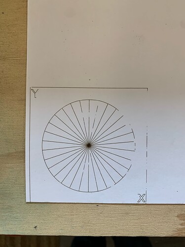

I cannot tell from your image where the stop and start points are. What you describe is what you get if the machine is bumped or shaken while it is paused.
When the machine is paused or stopped, the stepper motors power down. Then they cannot hold a firm position. You can manually move the head, which you should not do, and the laser is now in an unknown location.
If your controller will accept it, try setting $1-255 in the Console window. This will tell the motors to stay energized.

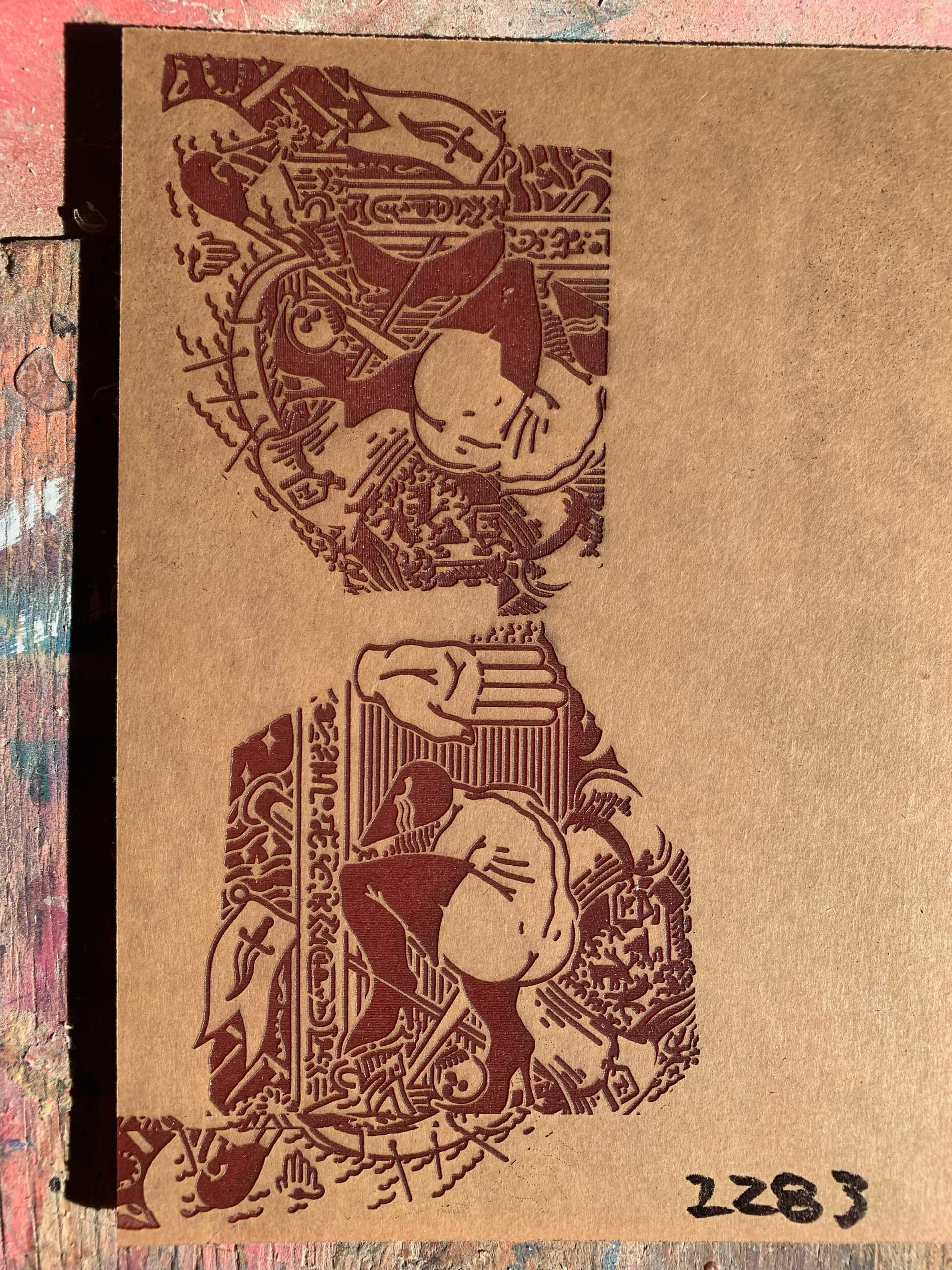

Hi Mikey, I am NOT bumping the stepper motors or the laser cutter at all, the machine is locked down to a heavy mount and the entire print-bed is in an enclosure. I have marked where the offsets are occurring within my image for you here.
Hi! I have run the test. The lines cut out a bit because I was running it as fast as possible but otherwise the alignment and calibration of the motors seems correct. I have re-attached my original images and have indicated where the offsets happen. Once again this ONLY happens when I pause and resume my machine during a long print.

I fing it really odd the offset is in one axis in the upper part, and the other axis in the lower part. That seems to indicate the possibility that the trolley and gantry cables might be snagging on something. Other than that, I am a loss at this time.

These are also TWO cuts on the same material, and in all three examples I have highlighted the image gets offset in the x+ dimension, I have just rotated the material between cuts.
I can also WATCH this offset happen when I hit pause on light burn and can see the laser continue to cut for 5-10 seconds before powering off.
I have not tried the $1=255 trick yet, but this is because I am extremely sure that bumping is not the issue here.
