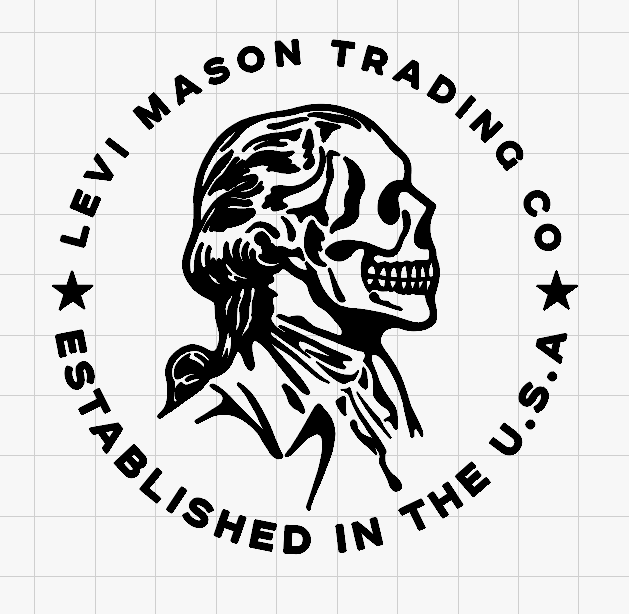

  2. In the second case with another Ai file, the design here is more elaborate, but also fully filled in. The image ‘appears’ in Lightburn when I load it, but only as an outline, and then even after selecting the whole thing and telling it to do a fill here, the mid part of the image gets totally ignored when engraved. I would say the file has a fairly sophisticated system of ‘layers’. I’m not sure if that matters.

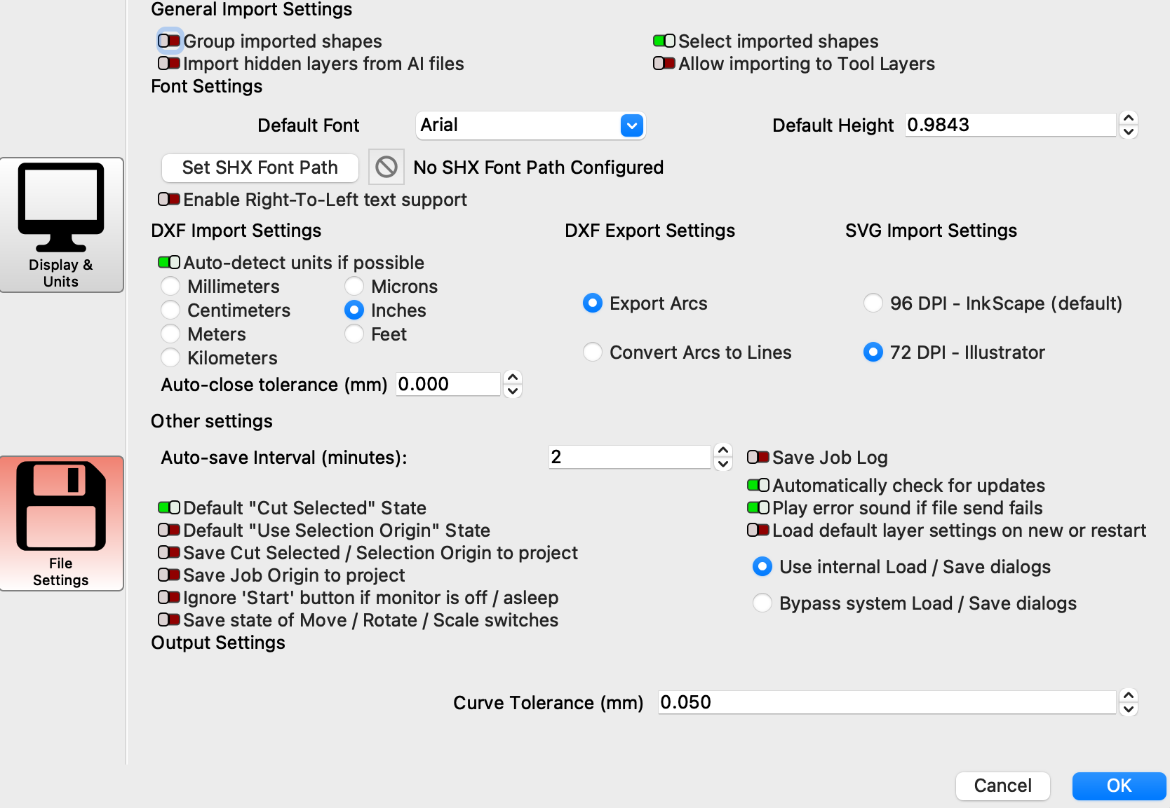

Posting the file will help. One thing to note, when importing .AI files it is important go to general settings<file settings and make sure SVG import settings are set to 72 DPI - Illustrator.

  2. For the coin file-- And unfortunately I don’t have Lightburn on my personal machine so can’t take a screen shot at this moment. But when I load it in Lightburn for the side profile of the face all you see is the outline-- And when I tried to select everything and just make the cuts as fills it worked for the text-- But the whole face section was totally ignored and didn’t get cut at all.

The setting you are referring to is just for an Adobe Illustrator SVG file. Not when importing a Adobe Illustrator AI file.

The head and two stars are duplicated.
  1. Ungroup the graphic
  2. Select the head and two stars group (just click on the head).
  3. Delete

I’ve just checked the Levi graphic in Affinity Designer and Inkscape and neither of those import as doubled so I think it’s a LightBurn anomaly.
I also checked in Affinity Designer, an older version of Adobe Illustrator, and Silhouette Studio, and can verify what @Marcus_Wakefield is seeing.
Thanks @Marcus_Wakefield / @RalphU. Unfortunately those I’m eventually training to run things won’t have access/be expected to know how to diddle in CC (or Inkscape, etc). Should I just have their art dept ship the files in SVG ? Or then what format consistently works here, at present ?
I don’t have access to Illustrator but I have opened your Levi coin file in InkScape then exported it as SVG which imports to LB correctly (I.e. without duplicated elements) so yes, SVG might be a better alternative.
