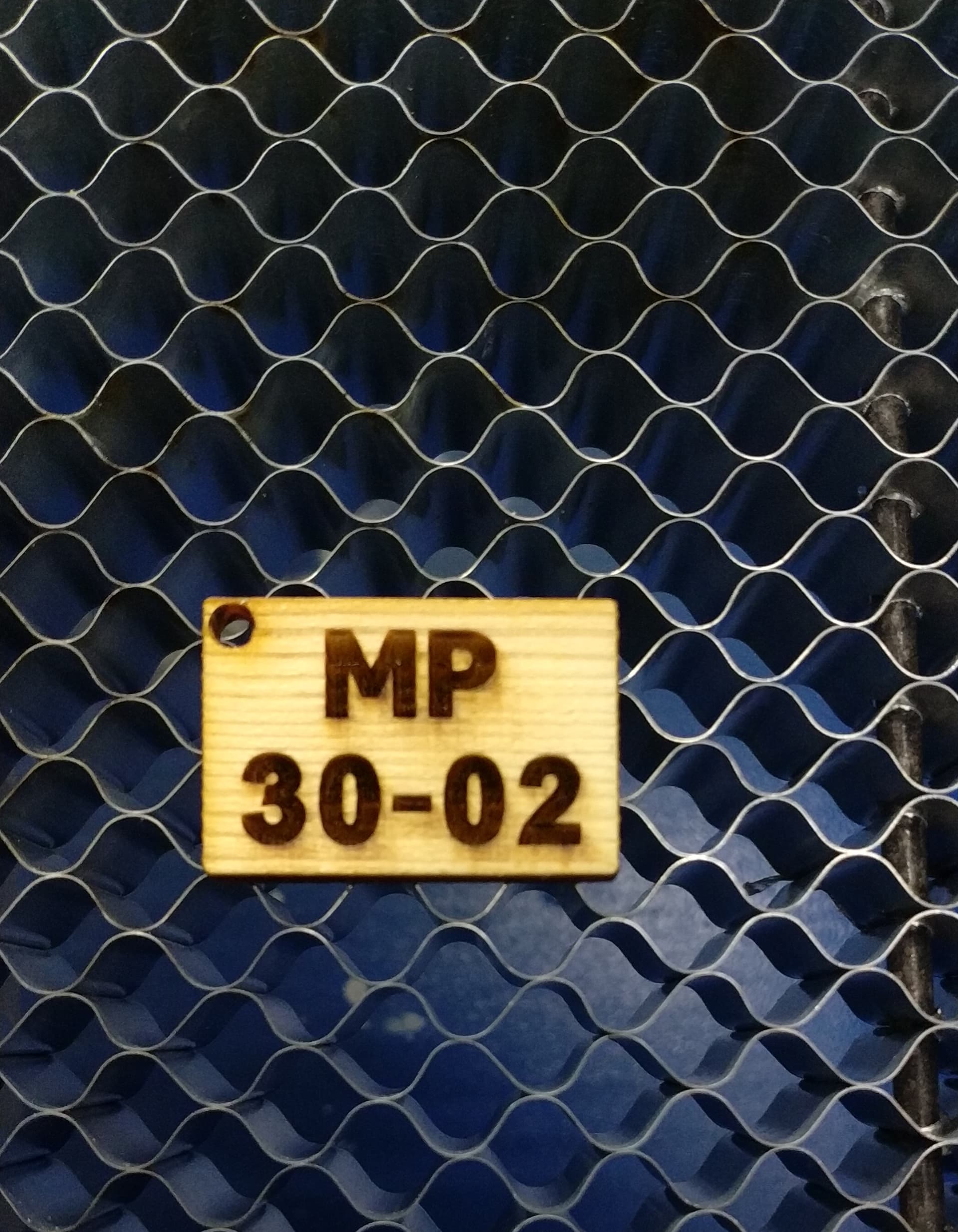

When i use Fill mode and set the scan angle to 90 degrees the final engrave is incorrect ,the issues isn’t present when using 0 degrees
Pic1 is my 90 degrees scan angle settings
Pic 2 is the what it engraved out
Pic 3 is what it looks like when using 0 degrees
It might help to know why you want to do this… I don’t use 90 deg scan because it’s most ‘mass’ of anything moving in there. I rotate the work piece if I need it scanned in that direction… However I would think it should work.
I have never seen a Ruida ‘off’ by that much. Good luck with the 1200+ dpi, as it’s probably not a reasonable expectation. I’m dubious of a 0.02mm ‘dot’ of most machines. With the stock lens, I’ have to work to be able to maintain a 0.10mm dot.

I could see the issue and I agree that it shouldn’t be a problem. Keep in mind that it’s not recommended for the Ruida to scan in angles other than 90 deg increments… Something about how the hardware works…
