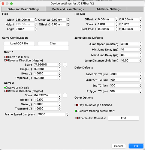

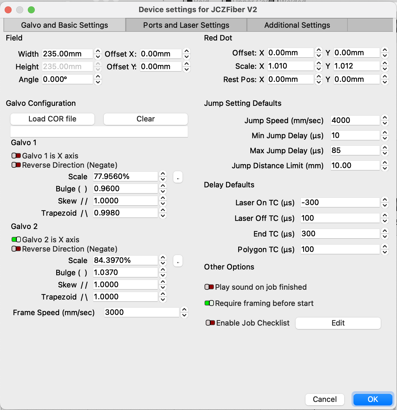

Good Morning! So, I have been attempting to work with Monport’s post-sale customer support and have gotten no where… I cannot for the life of me get the laser to properly mark on anything. I’ve narrowed it down to a configuration setting issue because they keep sending me config files for the right machine with the wrong lens… Last night, I went in and changed some settings to the field sizes, but I have no idea on the angle because they won’t provide that to me… I am attaching a screenshot of my current settings.
Machine: Monport JL-F30W Split MOPA Fiber Laser
Lens: F-Theta 1064nm f=254mm 254D20441
Host Computer: MacBook Air M2
Lightburn: 1.6.00

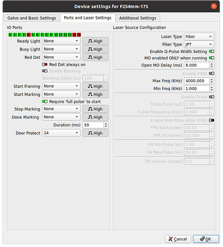

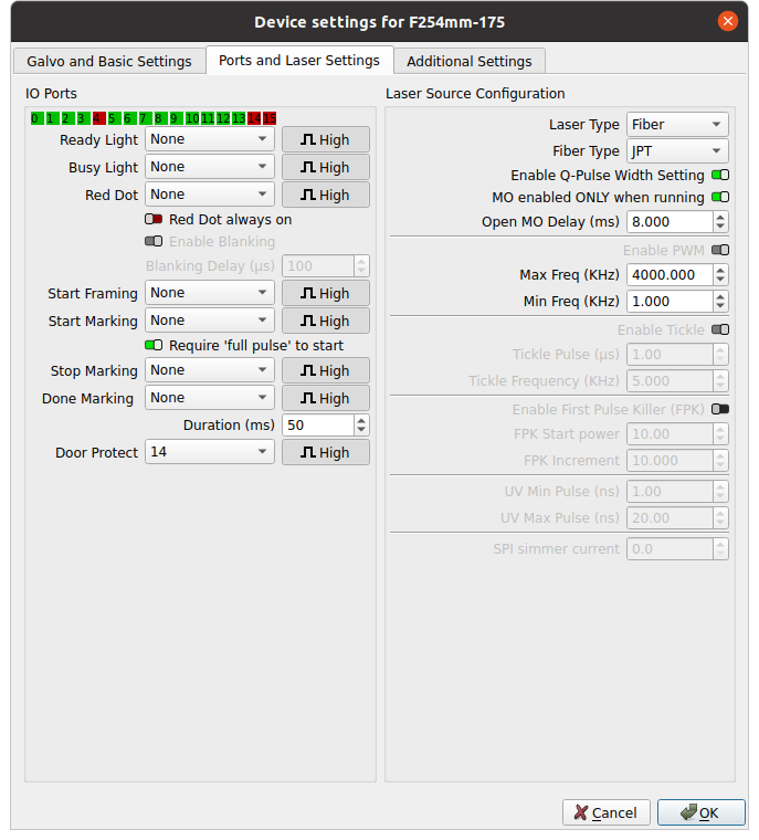

What kind of source do you have?
Here is mine from an M60 JPT M7 MOPA… The delay defaults have been zeroed out, but yours are close to what mine were. I also load a cor file that sets up the lens correction. You should be able to do this Laser Tools → Calibrate Galvo Lens
