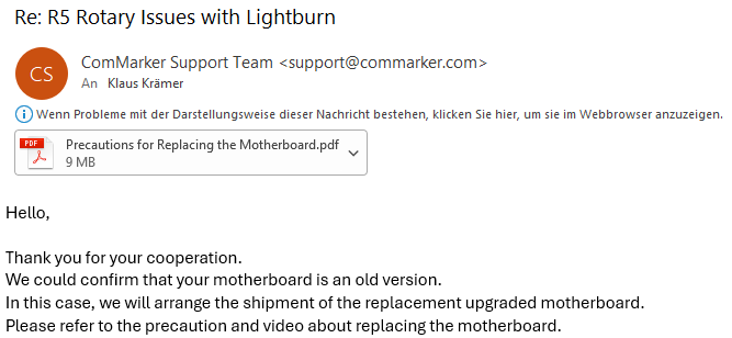

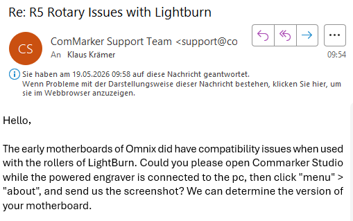

For now, the culprit has been detected:
See the communication from Commarker’s support team:
… and here it comes:
**So I’ll mark this thread as solved an will wait for the new motherboard to arrive.
Thanks for your commitment, trying to help!**
