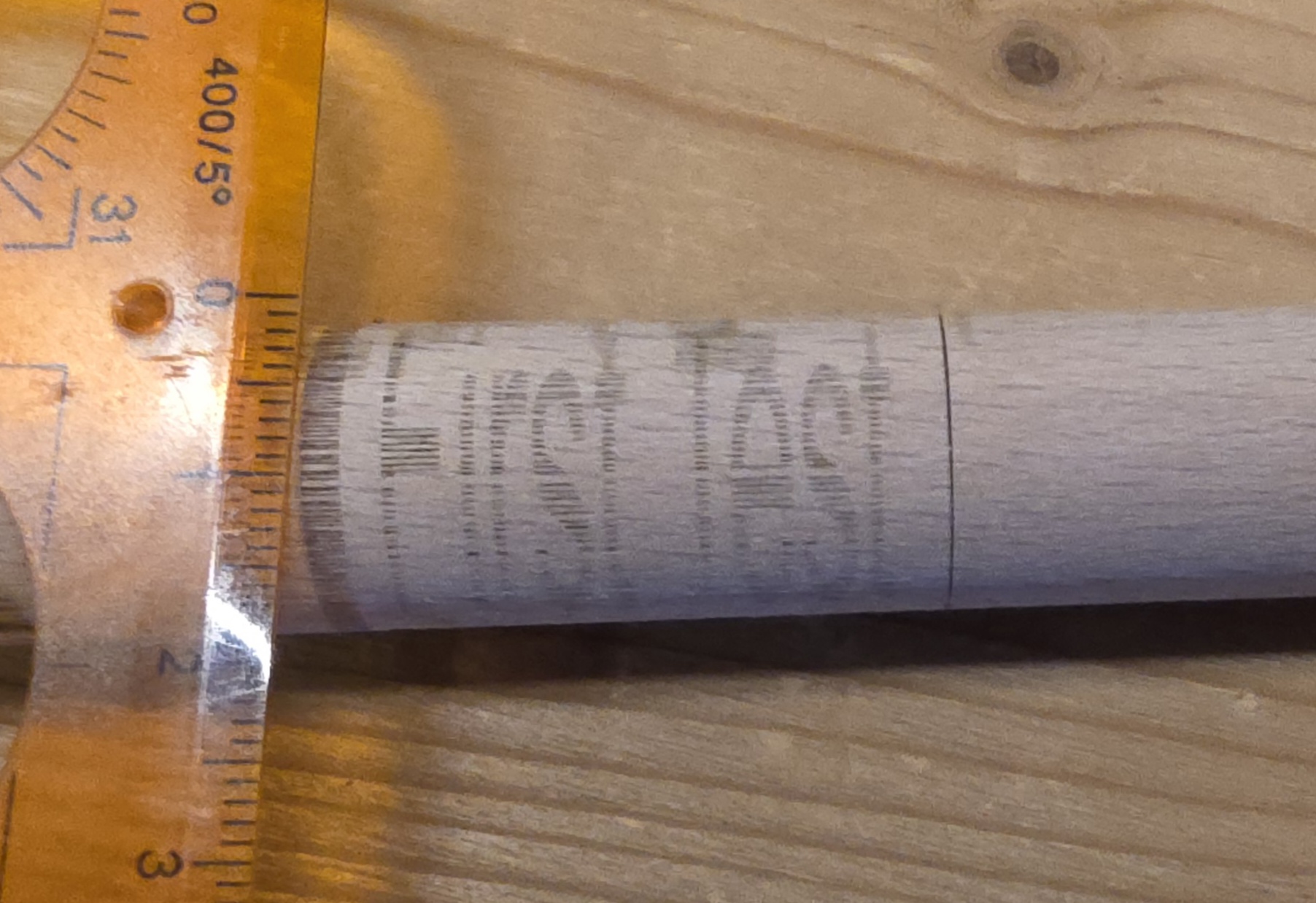

I just try to make my first steps with the R5 rotary (chuck) and my Commarker Omni X.
First of all: Why does the Lightburn workspace not adapt to the actual circumference of the work piece in direction of the rotary axis?
With the data Commarker provides for settings, a text of 7mm font height will be around 24 mm when engraved on the test part.
I tried to alter “Steps per Rotation” value to compenste, but that results partly in chaotic hopping hence and forth around the Y-Axis.

At first read your steps per revolution are probably incorrect. What happens when you hit the TEST button? Should get exactly one revolution. As far as adapting to circumference, why? It doesn’t adapt to the size of an object on the flat. Maybe I misunderstand the question.

Commarker’s rotary manual says, it’s 12800 steps per rotation, which makes sense, as the laser spot dimension of the UV laser beam is about 0.0019mm.

This has nothing to do with each other at all. The steps per rotation is a hardware setting for the rotary stepper motor. The rotary can be used with any laser, with any beam size. The beam size is totally independent from the rotary steps.
If you enter the 12800 steps and click the test button, does the chuck turn exactly 360°?
As I mentioned before: It’s turning about 4 times.

Ser your steps to 51200 and test.
Testing multiples and fragments of the steps has been part of my trying. This led mostly to erroneus movements of the rotary.

This indeed sounds like a defective board. Changing the steps/mm should never affect the function of the movement (only the distance). So it sounds like the board can’t compute the stepping timing in other cases.

12800 = 0.028125 Deg/step.
With 12800 step/rev we are getting 1440 degree, 4 times more.
So 0.028125 ÷ 4 = 0.00703125 Deg/step.
For 360 deg ⇒ 360 ÷ 0.00703125 = 51200 steps.
I may be wrong.
Here’s my thinking;
12800 equals the number of steps the stepper motor needs for one complete 360° revolution.
Klaus says 12800 creates about 4 revolutions. So why not 12800 ÷ 4 = 3200 steps.

Correct. If the microstep driver gets 3200 pulses from the software, and is set to 3200, it will command the stepper motor to rotate 360 degrees. A gear or belt/ pulley reduction may change the chuck rotation, but the stepper motor will rotate 360 degrees. If the microstep driver gets 12800 pulses from the software, and is set for 3200, it will command the stepper to rotate 1440 degrees.
If there was a 4: reduction drive, it would rotate 360 degrees.
